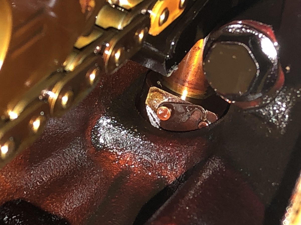

Have a 01 2.4 that was throwing a p1300 code, truck wouldn't start up. Replaced all 4 coil pack, checked all the grounds, and replaced the crank position sensor. Still had the same issue, we pulled the valve cover off to check the timing, chain still seems very tight (200k on motor). I did notice this one little link that looks like maybe it's supposed to be hooked onto that pin? Any suggestions would be appreciated, Thanks
