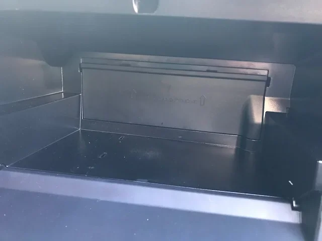

It was easy to install.

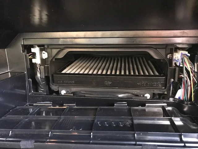

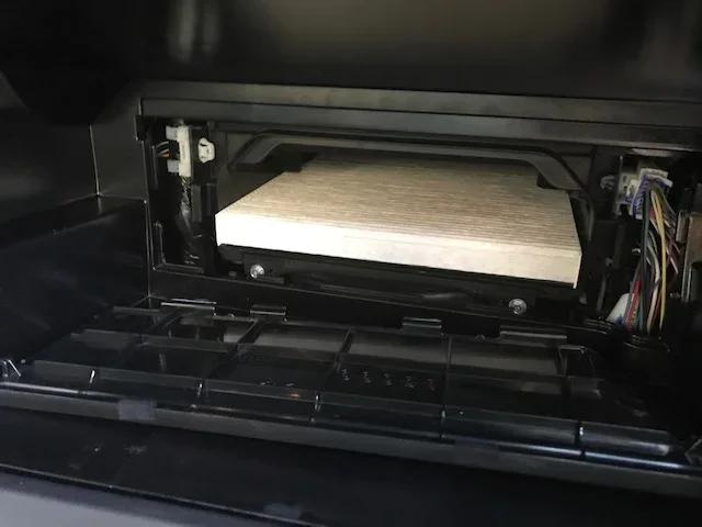

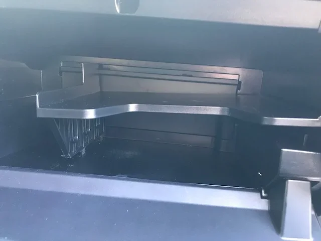

Open glove box, to remove dividing tray, pull up on left side until tabs pop out then slide to the left to release tabs on right. It may need some strong encouraging to release tabs. image1.JPG Pull up on upper ridge to remove door to access cabin air filter coverimage2.JPG Press the two tabs on either side of air filter cover inward and pull outward to remove cover image3.JPG Remove OEM filter image4.JPG Slide K&N filter into place (note it's shape and how the OEM was removed for best fit) image5.JPG Reverse process and done image1.JPG clean yearly or as needed and never have to buy another cabin air filter.
