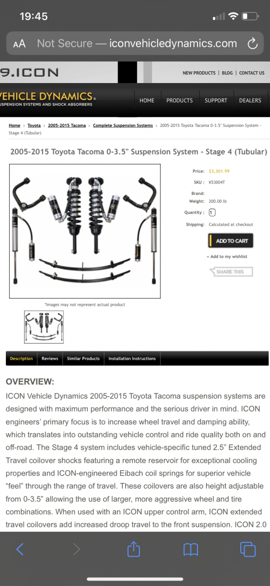

Im looking to add 35s. Regear as well with 5.29s. I don’t have lockers but looking to add them in the front only. I own a 2015 SR5 DCLB with 4x4 and slip differential. It will be my build/project truck. I’ve kinda already have a knowledge of how much I would be spending but for sure ain’t gna drop 10k one shot. Progress build. If I go with kings then ofcourse I’ll need new UCAs but the icons sell compete kits just without LCAs. Yes, I will plan on adding weight as well to include bedrack roof rack, winch, rock sliders, front bumper, a RTT and maybe just bottom skid plates.

Little secret, I bought my kings with adjusters, AAL, icon delta joint uca (should have gotten TC) for 3400 shipped [emoji16]. I would recommend 4.88s instead of 5.29s and actually for a second gen 4.56 would be a better option as well. I would stick with either 2.5 or 3, 700lb coils to cover bumper, winch, skids, batteries. You can find good deals on 2.5s since kings dropped their 3inch kits. I would also look into ADS as well. There was a group buy going on TW with some good discounts.

Coilovers cranked up to max height are going to ride like crap. You could go drop bracket lift if you really want that much height but it's basically irreversible because you have to cut the crossmember. I guess someone good could weld it back in. A drop bracket reduces from ground clearance though.
