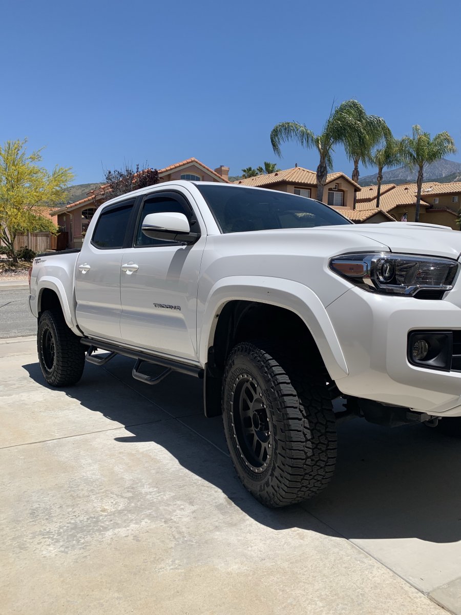

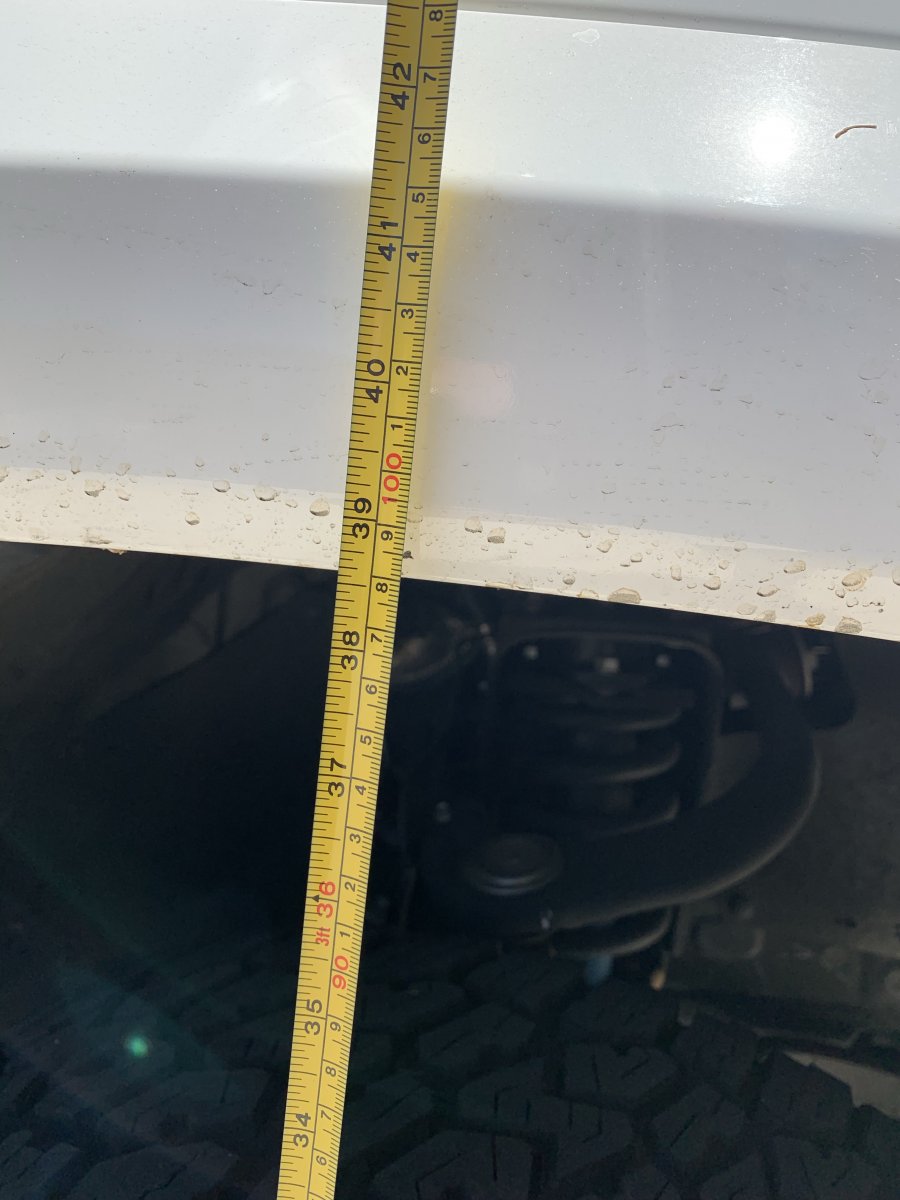

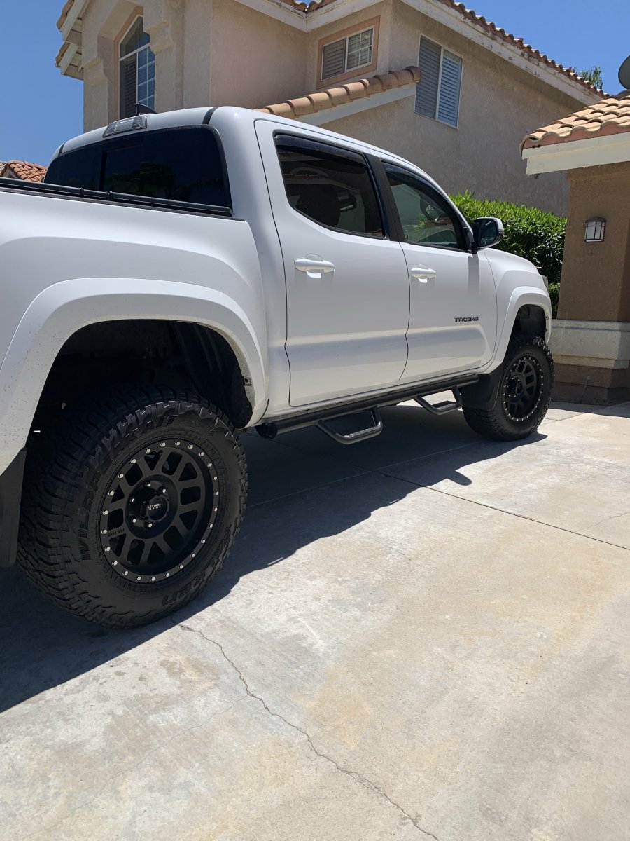

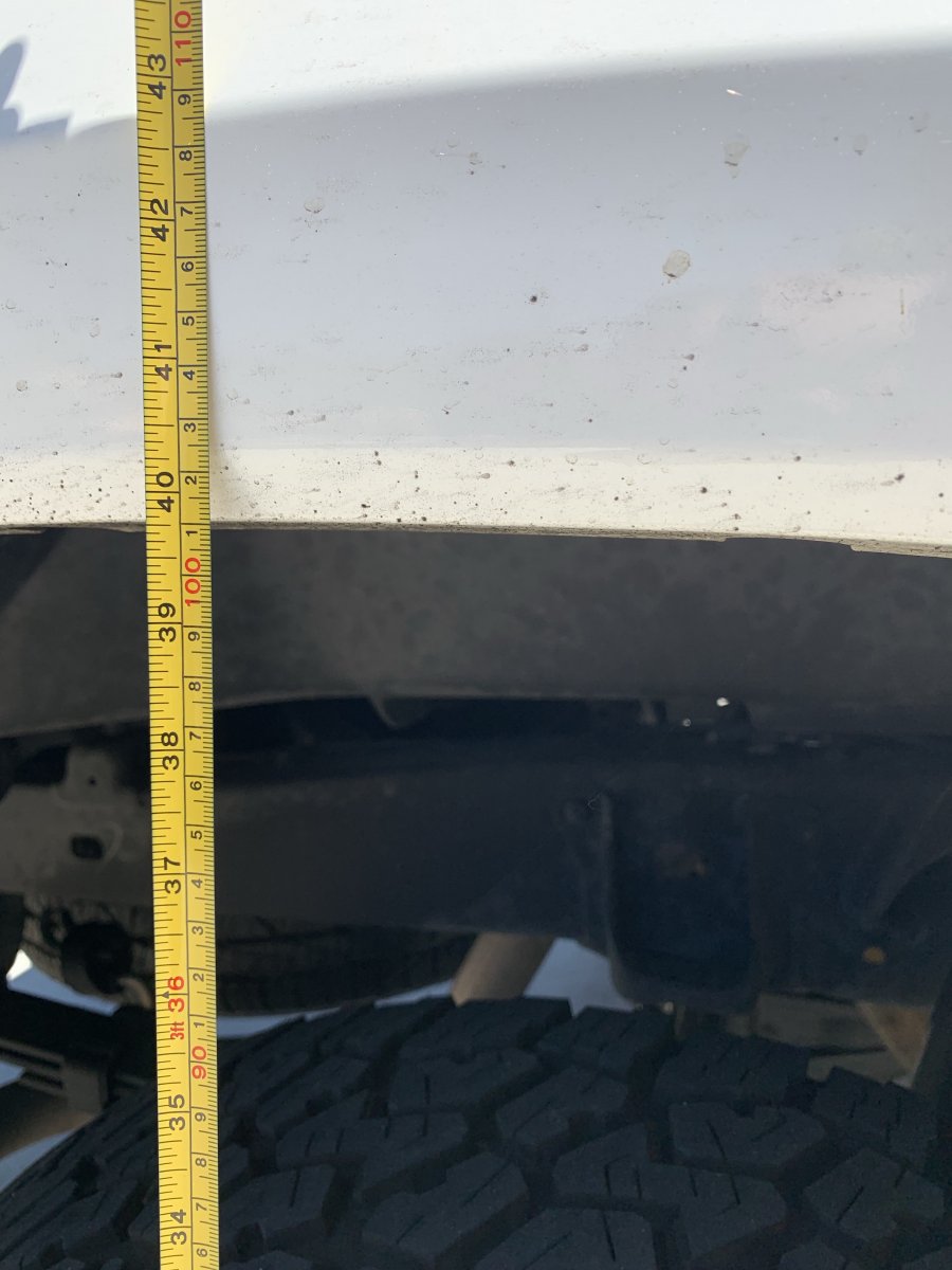

I purchased a 2017 trd sport that came with a level kit and wheels. It sits lower in the front and it bugs me a little. How do I figure out what size kit it has? The tires are 265/70/R17 with Method rims. I measured the block in the back and measured 2” but the front is hard to get an exact measurement but looks like a 1.25” or 1.5”. When I search on the web for level kits, they either come in 2” in the front and 1” in back or 3” front and 2” back nothing close to what I have. Should I replace the back with a 1” or go bigger in the front? I want the front slightly higher. As u can see in my photos the back sits 39.75” from floor and front at 38.5” total of 1.25”s lower in the front.

Fwiw, measure center of hub to bottom of fender flare

You have a 3” in front and 2” in back the truck has an OEM rear rake of ~1”. That kit has you about as high as you can go up front before you’ll need UCA and get into $$$.
Thickness of spacer doubled is the lift it gives. ie 1.5”=3” lift 1”=2” lift 1.25”=2.5” lift
I’d listen to @whippersnapper02 ditch the spacer/block and get something that will level it and improve the ride.

What if I replace it with a 2” or 2.5” spacer in the front? I just want it level or little higher in the front. In the future I’ll get a real lift. I don’t want to ruin anything either. If u say this is the highest I can go with spacers then I’ll just deal with it for now. Was looking for cheap option to make it look the way I want it. IMG_8788.jpg
How is 1.5” a 3/4 spacer? People say I have a 3” lift kit but how is that if my blocks in the back are 2” and the front appear to be 1.5”

Measure center of hub to bottom of fender flare
Write down
measure yours, center of hub to bottom of flare
Do maths to find your lift ROUGHLY.... Trucks settle differently
They already gave u the maths to figure out how spacers work.... Multiply the thickness of the spacer by 2....
