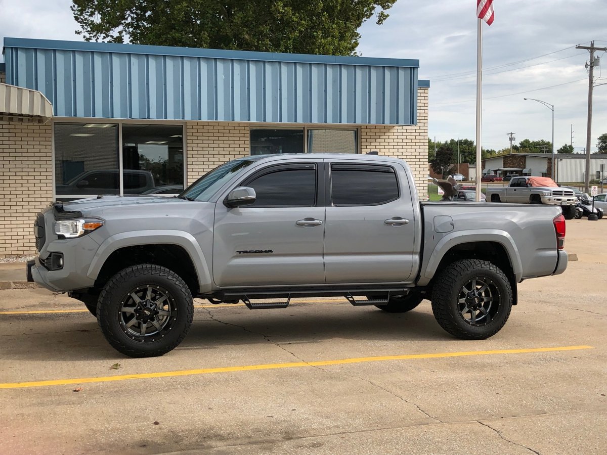

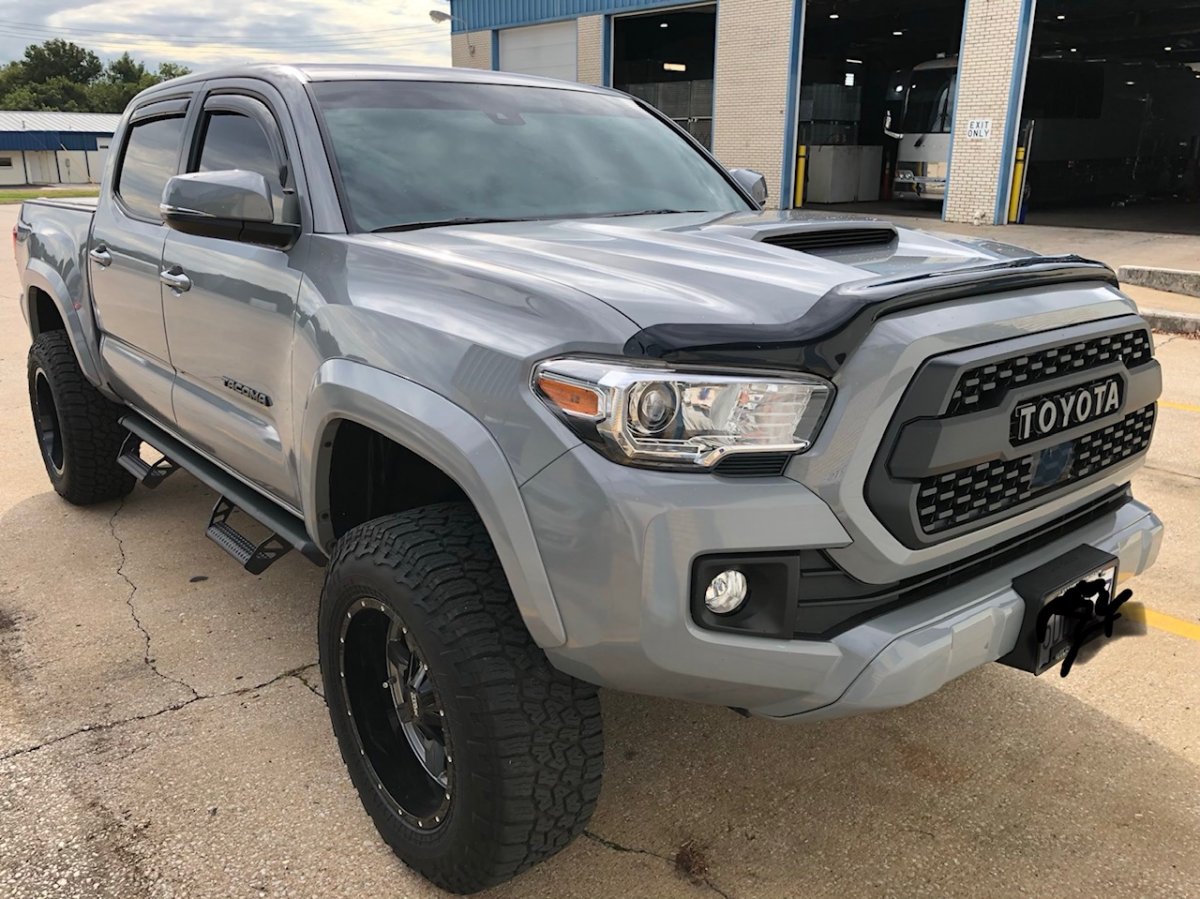

I get 16-17 city and 18-19 highway with that set up as long as I stay under 70, Once I go over 70 its 15-16. I have never driven it with out a lift on it so I am not sure how those numbers compare to stock. I do have a K & N cold air intake and MBRP 3 in exhaust on it also
