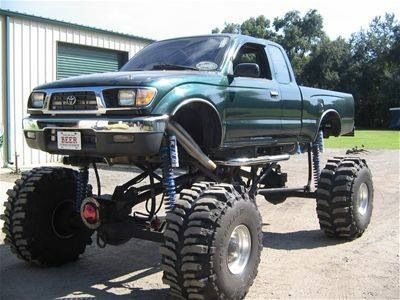

There's always Bulletproof Neveroffroad suspension:
Searching for the ultimate potato lift kit system for your 2005+ Toyota Tacoma 10-12 Inch 2wd/4wd? Your search is now buttered, sour creamed and chived!
https://www.bulletproofsuspension.net/toyota-tacoma-10-12-inch/
