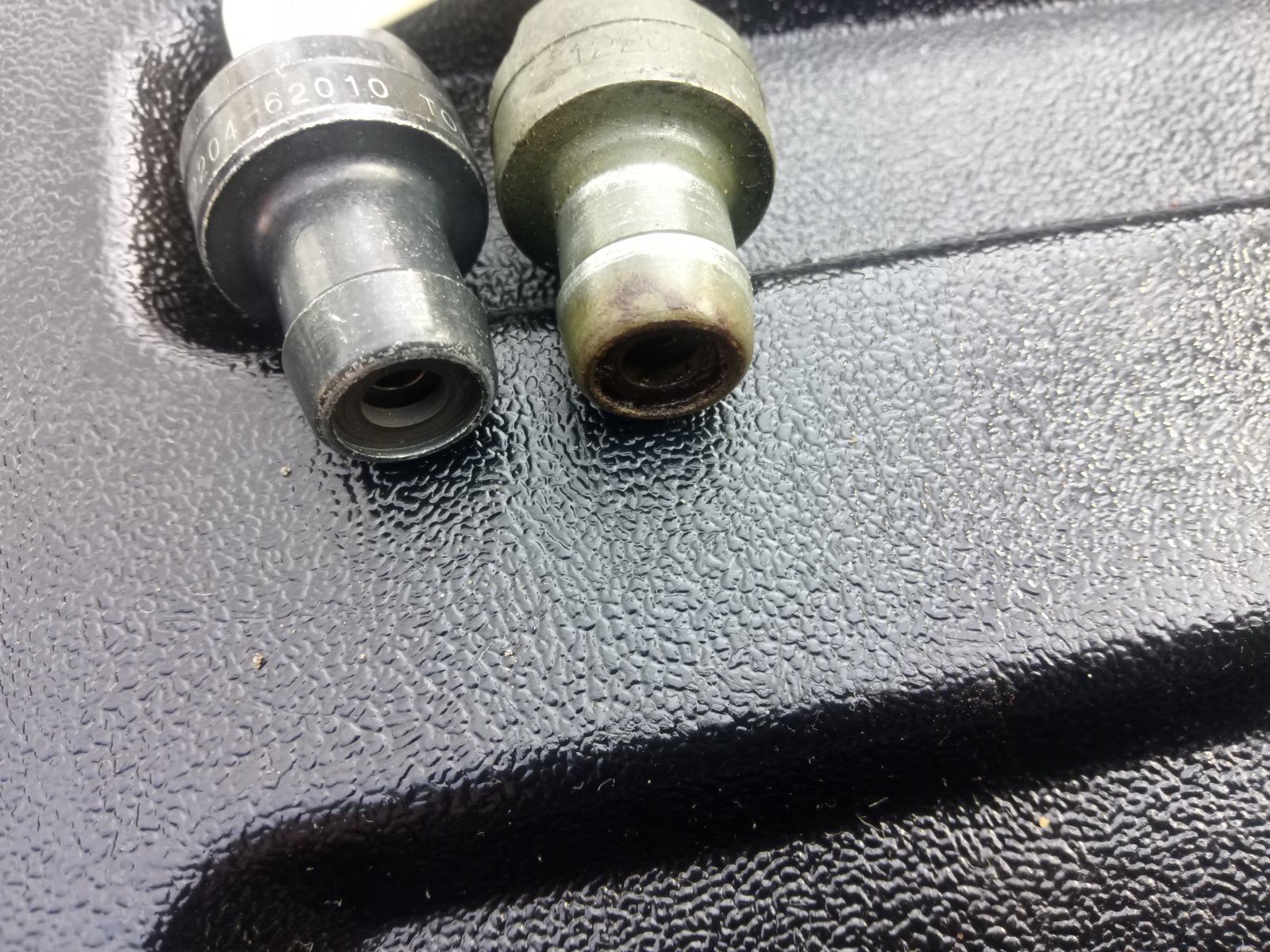

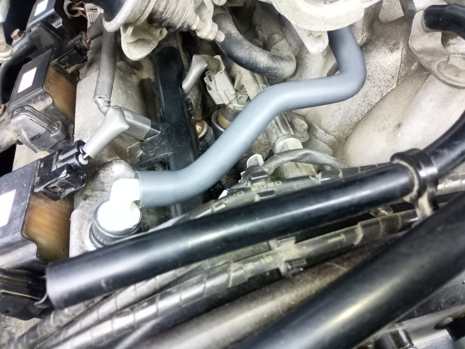

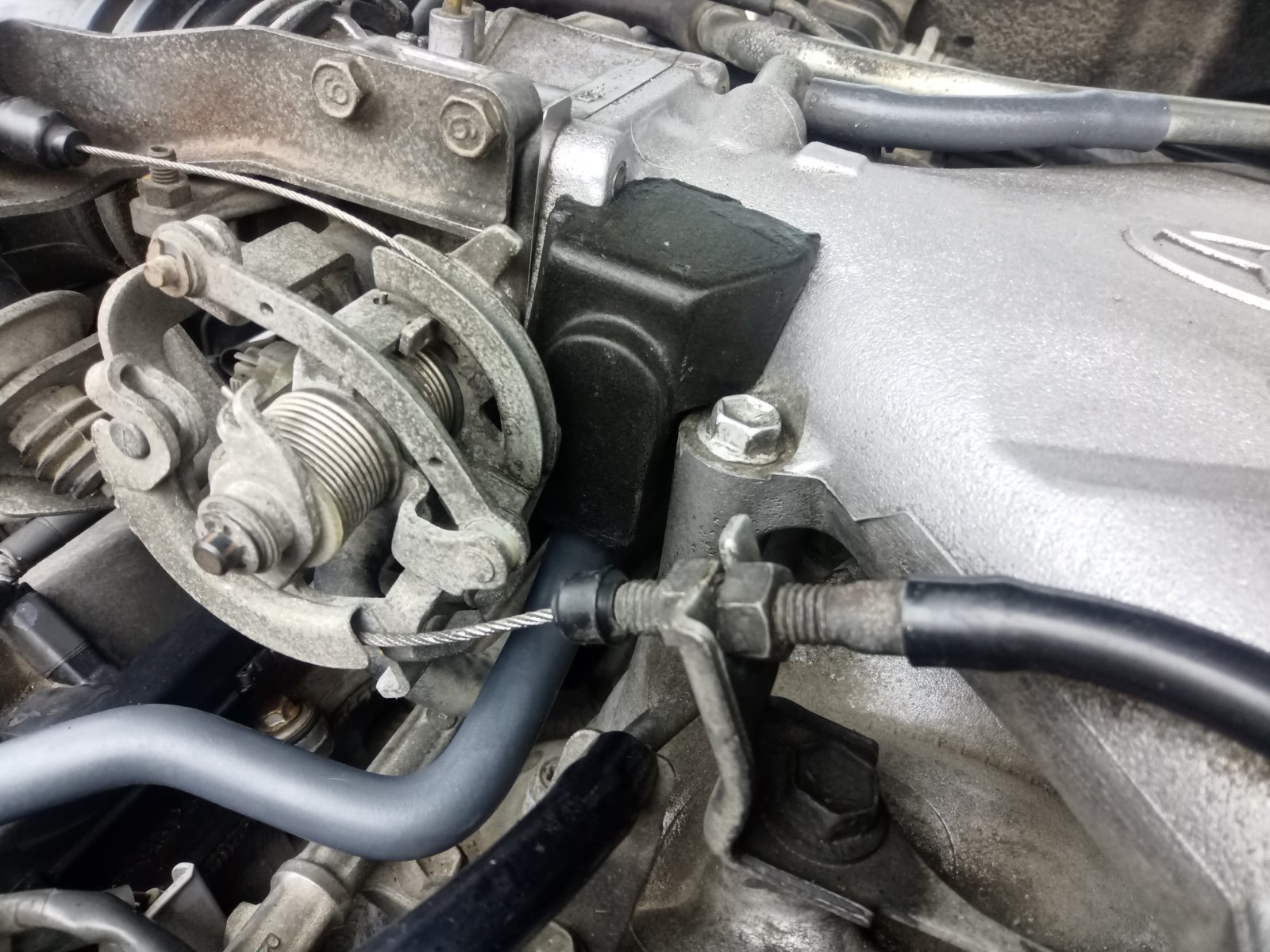

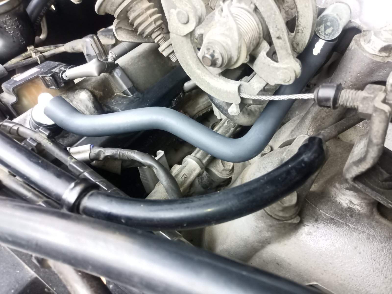

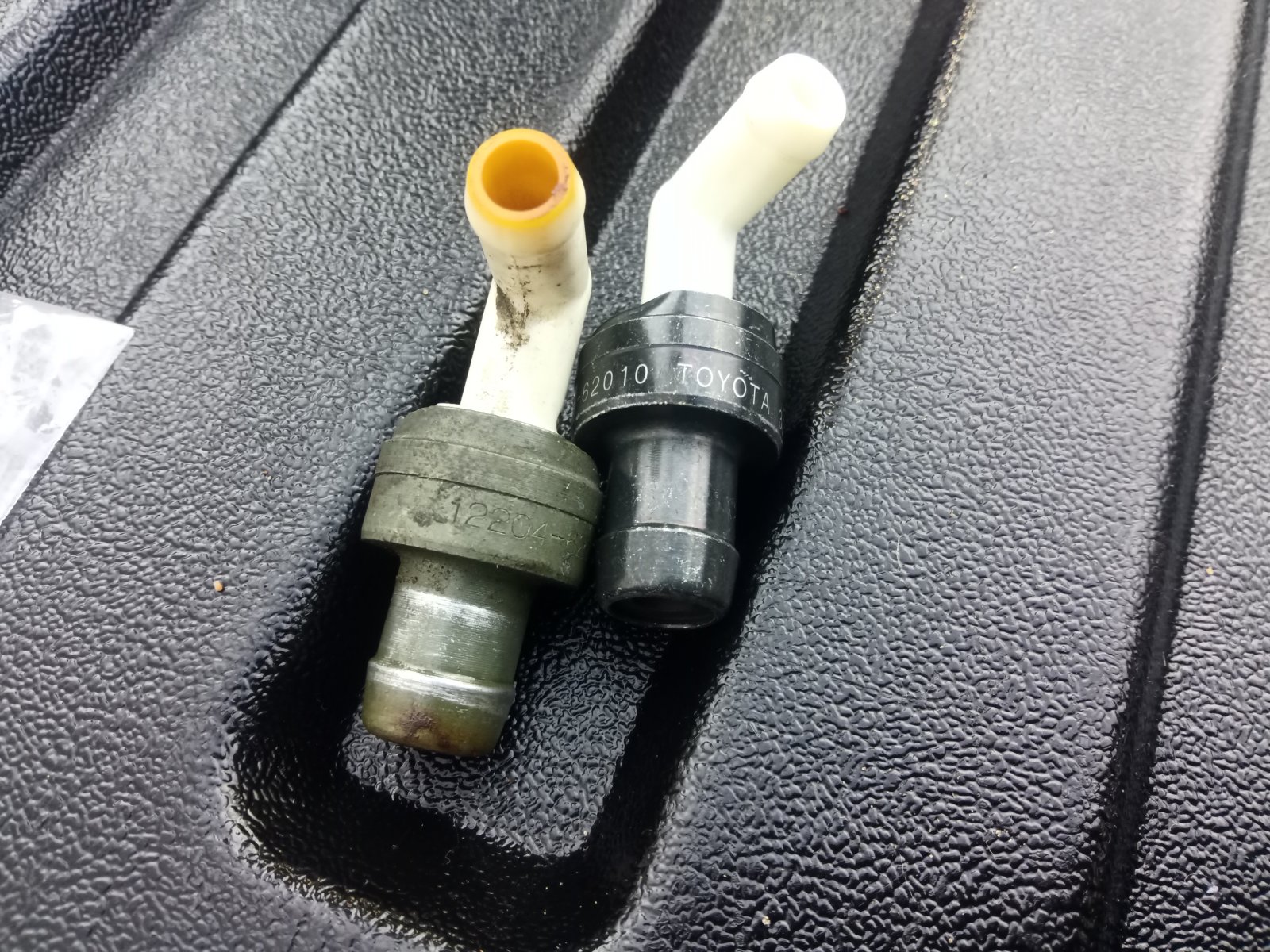

new pcv valve + hose ... aged 27 years
JayQQ97
346346 miles on original valve + hose
THIS is the new setUp...
IMG_20240330_171647_589.jpgIMG_20240330_171234_371.jpgIMG_20240330_171619_715.jpgIMG_20240330_171638_916.jpg

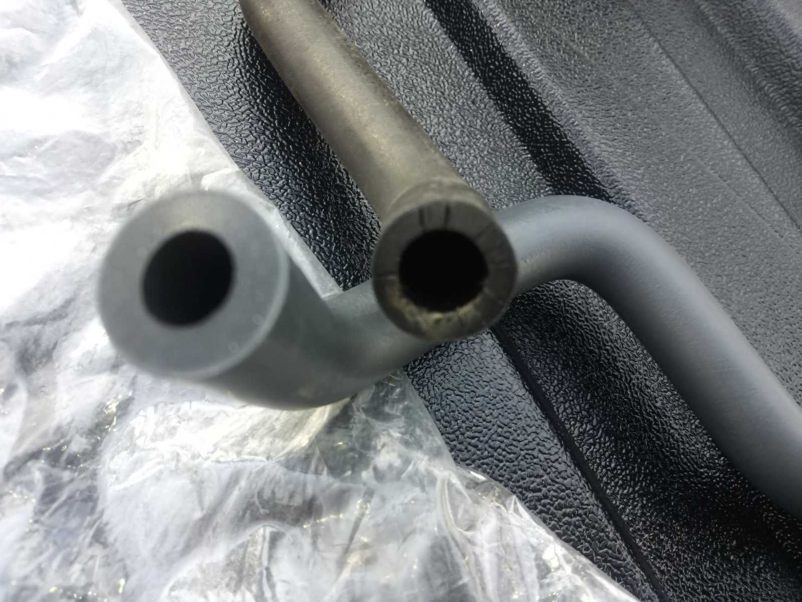

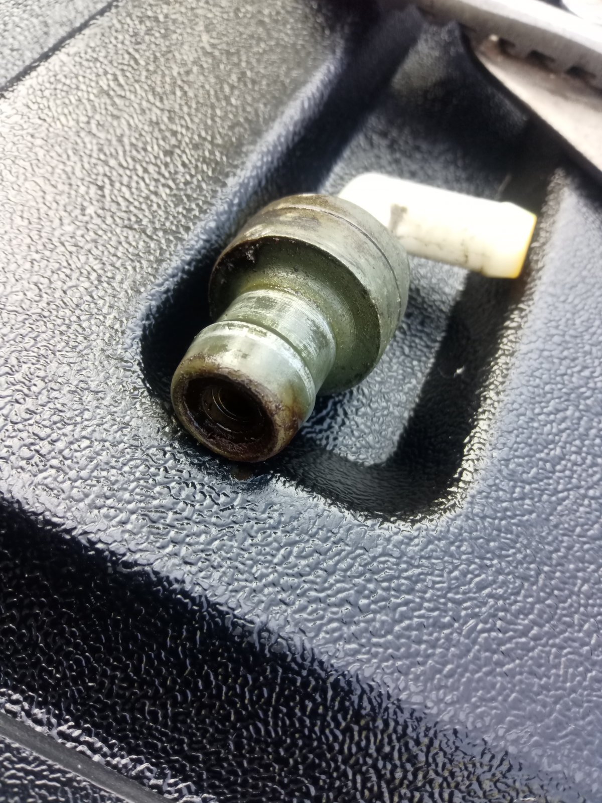

Just barely got a rattle
Noticeable diffrence compare to new

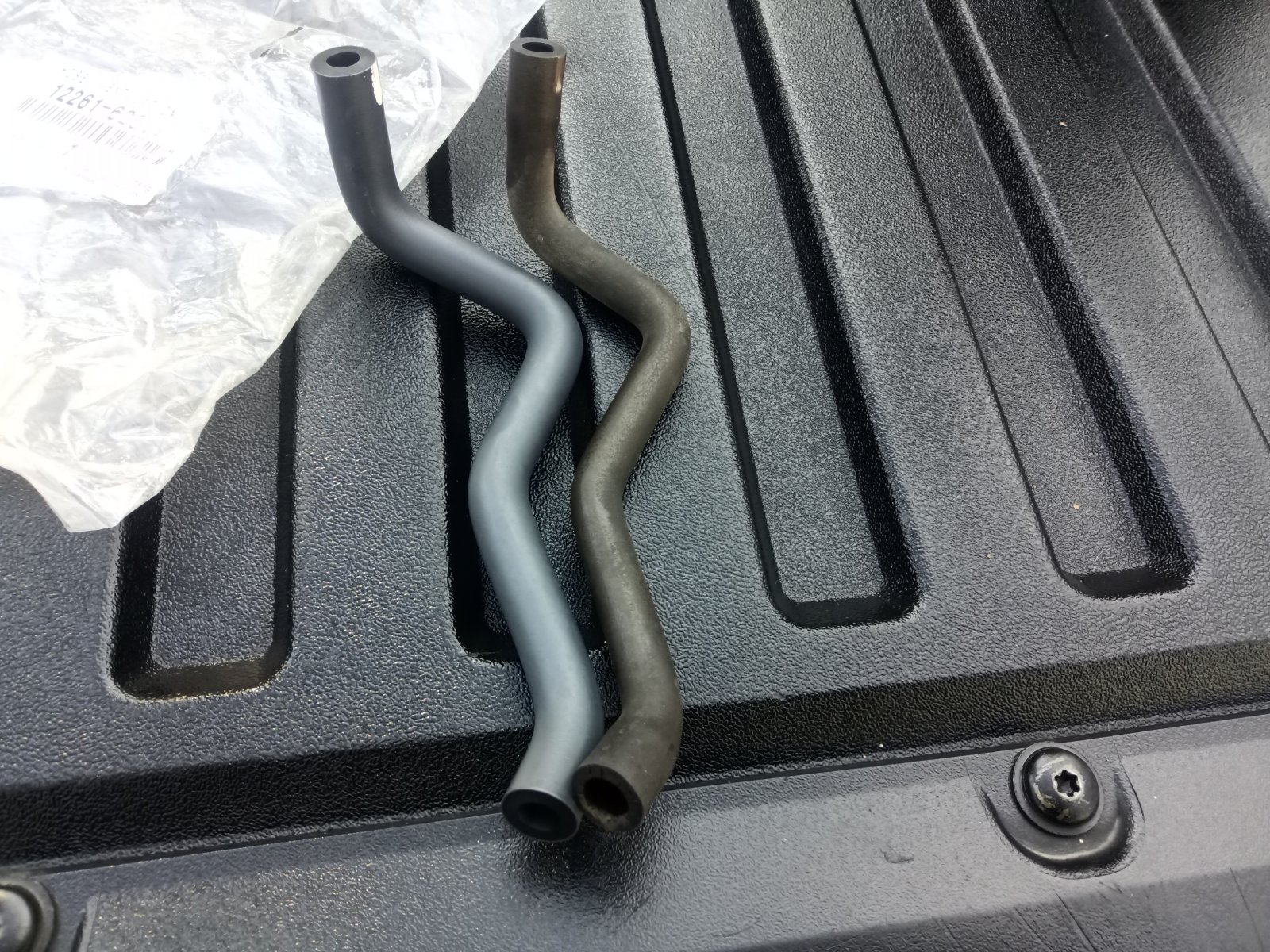

+ Old hose harder than lava rock

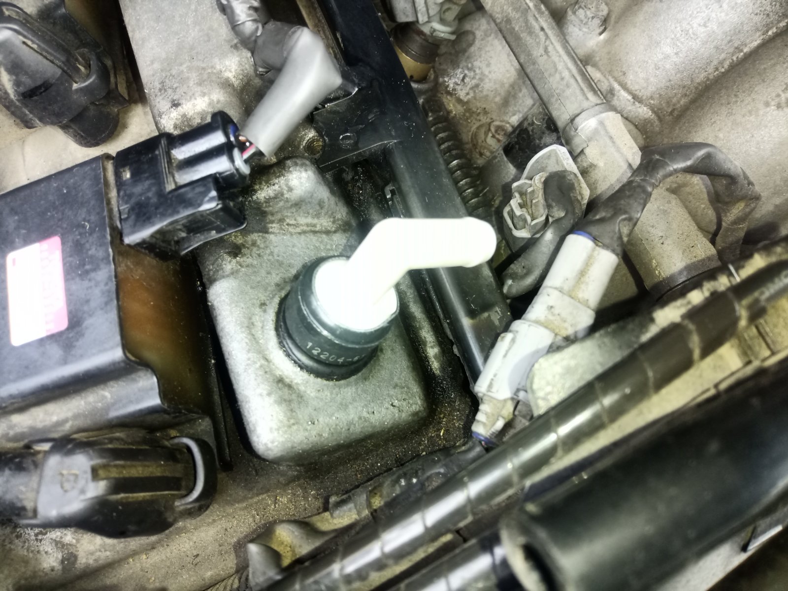

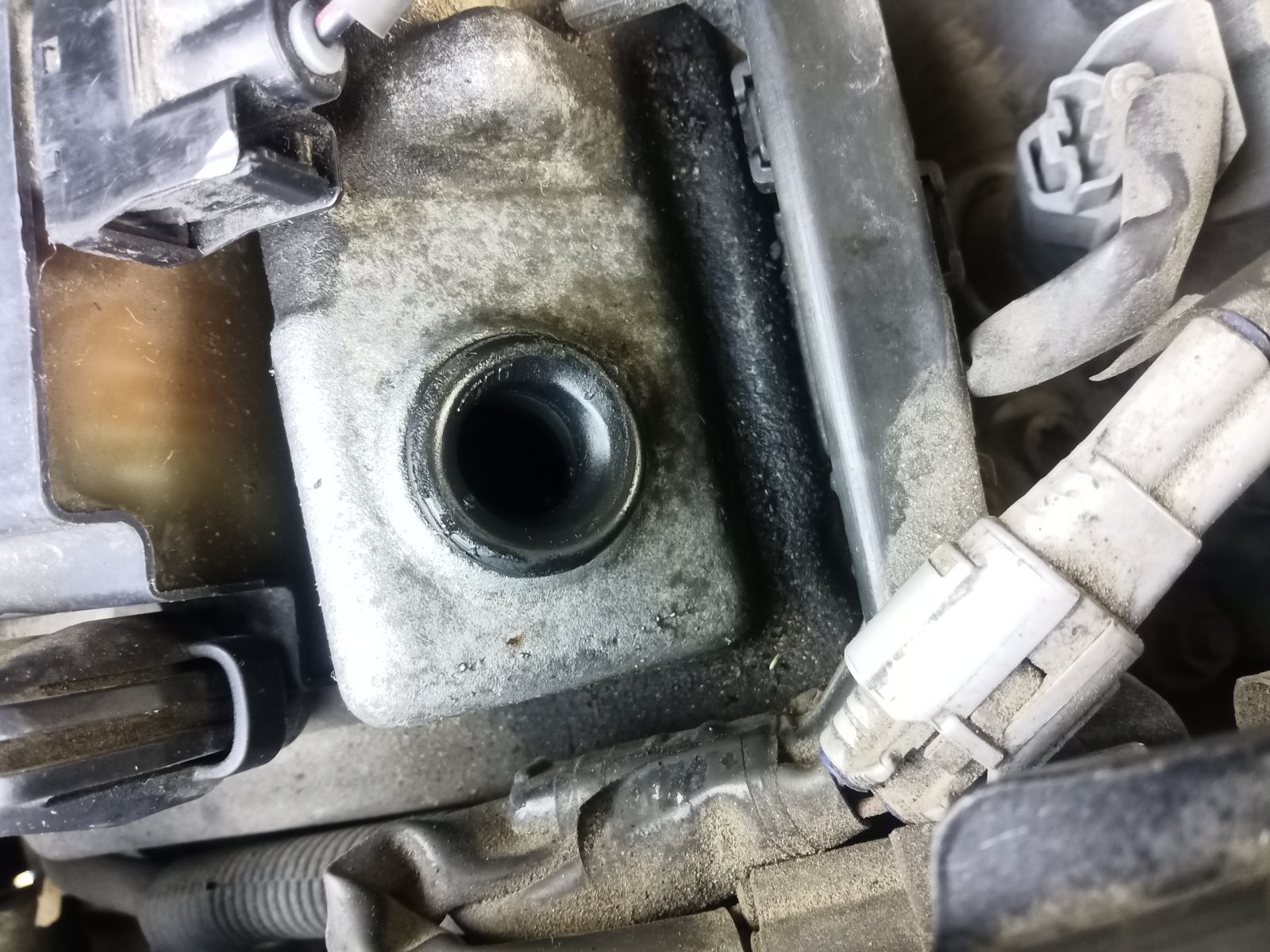

The whole hole

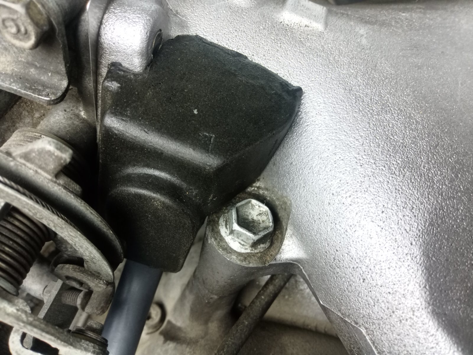

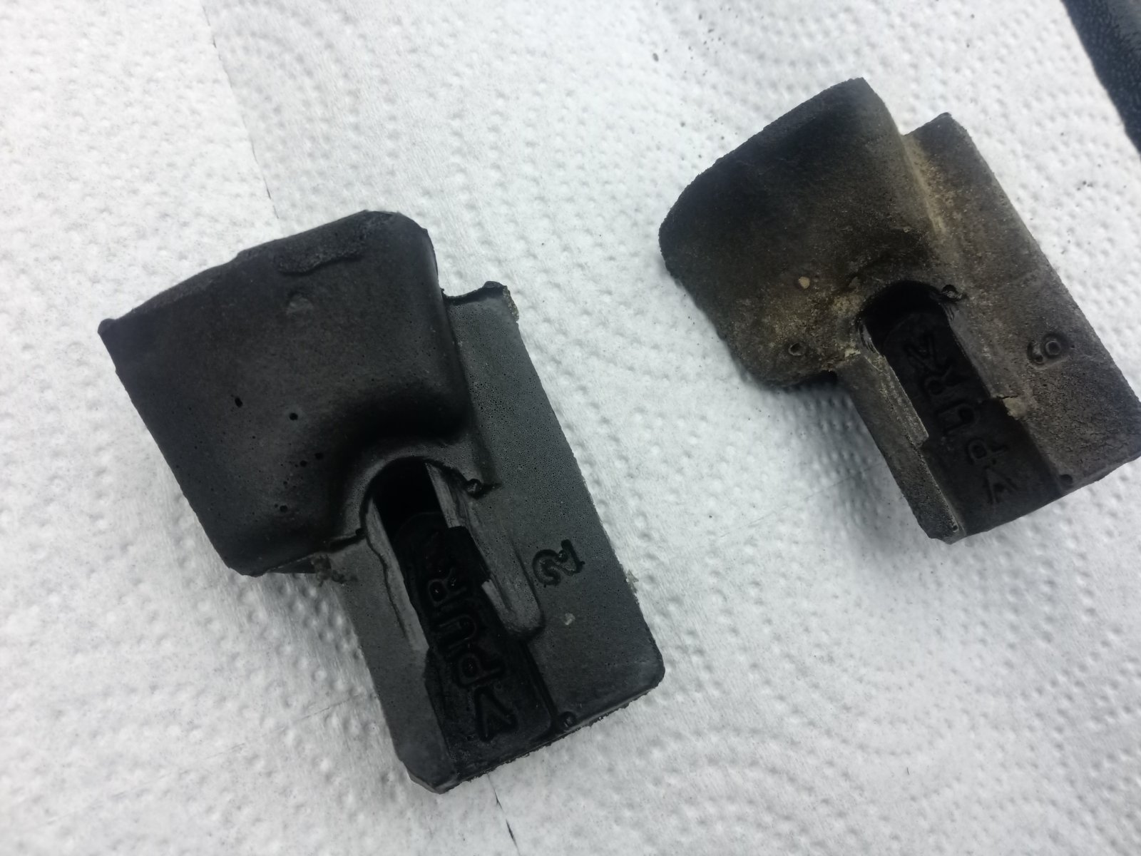

Left the grommet, it might be only 5 years old
replacement scheduled with an upcoming sooner or later VCG procedure

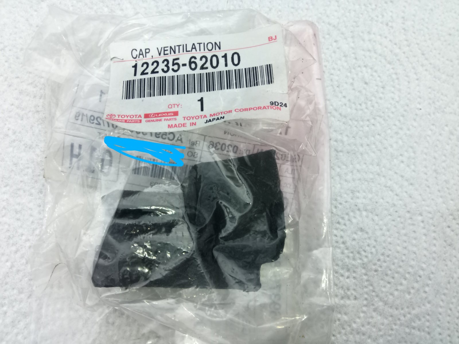

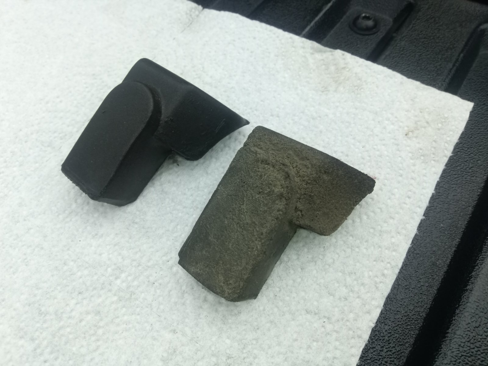

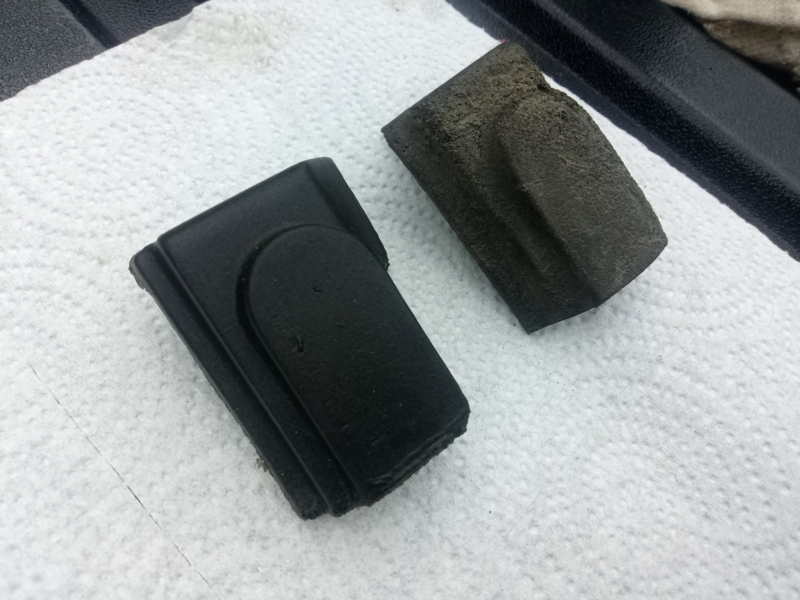

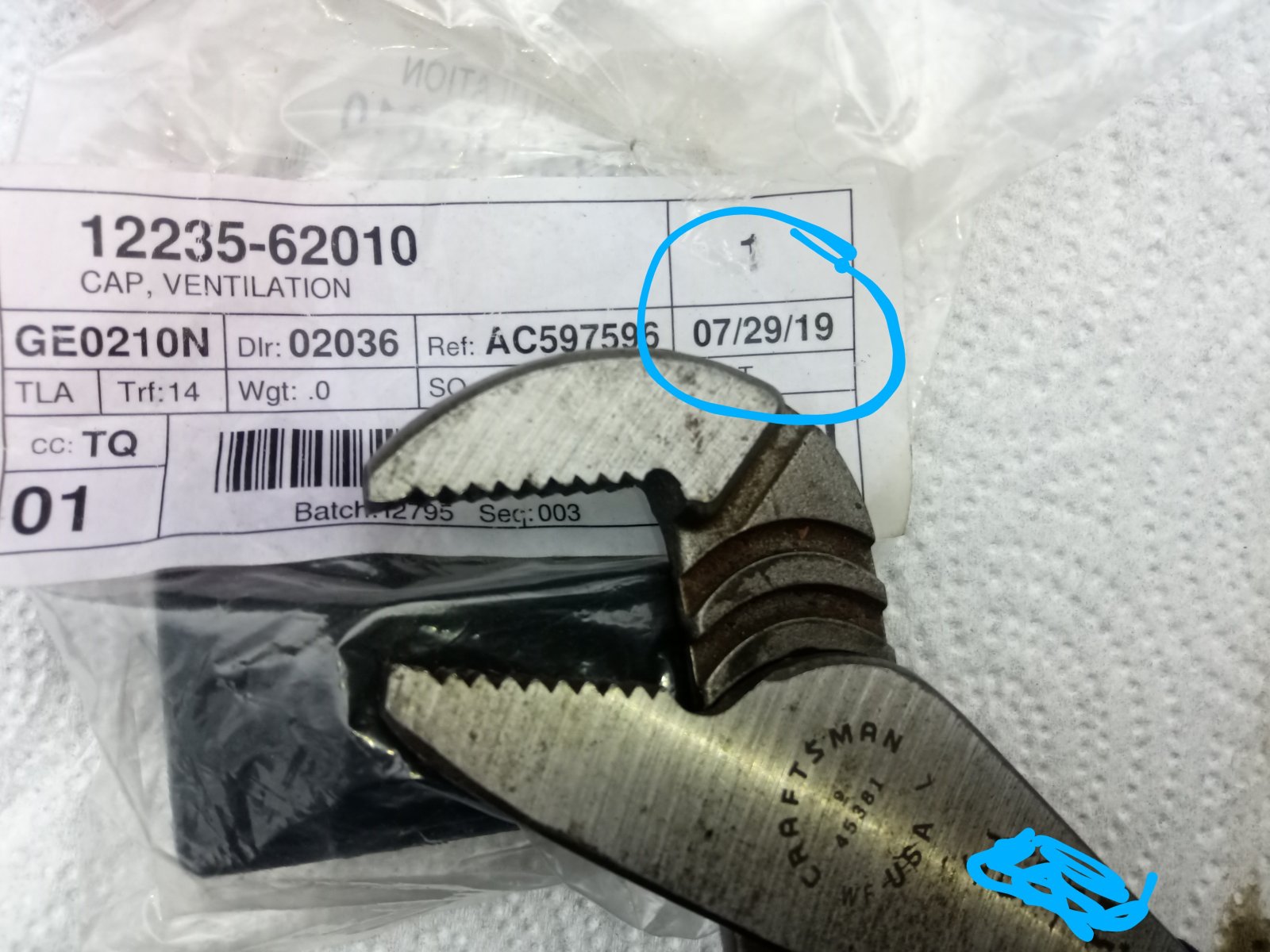

replaced the breather foam cap
I bot it about 5 years ago and it finally got put to good use

Long as you can hear the pcv valve rattle its still working. Its when you shake it, and hear, or feel nothing, it becomes a paper weight.

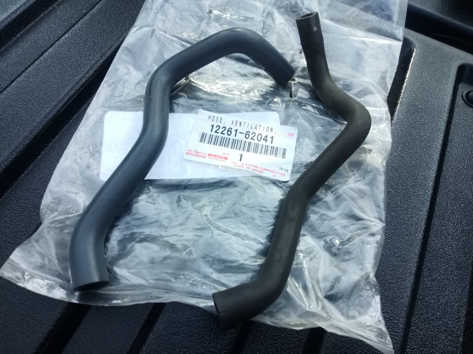

Btw, those oem toyota hoses are ridiculous money. I just use some generic 7mm hose thats rated for the same purpose.
yes, that hose even after the neat discount off of MSRP was a bit over 10$
BUT it is form fitted to exact match and contour, unlike generic hose likely is not matched to perfection fit
If I ever paid $10 for one short piece of hose like that, I commit myself. I had several on my tundra that cracked apart. Who gives a crap if form fitted, I don't live with my engine, or look under the hood at it 24/7. I bought several feet of 7mm hose rated for fuel for a few bucks, and cut it as needed replacing many of those hoses. Truck ran fine, no cel's.
Well, I'm not independently wealthy enough at this stage that I can afford a dollar an inch hose. Even if I could, I wouldn't own a tacoma...I'd have a chauffeur, and a limo.
that particular hose is form-fitted for a genuine purpose or so i suppose it is
please do tell me why that is, tacoJoel
thank you :)
I could see form fitted coolant hoses to the radiator, but these small hoses like that tied off with a couple wire ties in critical places is just fine....its what the average auto shop would do saving the customer time, and money, rather than the need to order. If you need to spend foolishly, they need more guys like you...you're good for the economy.
