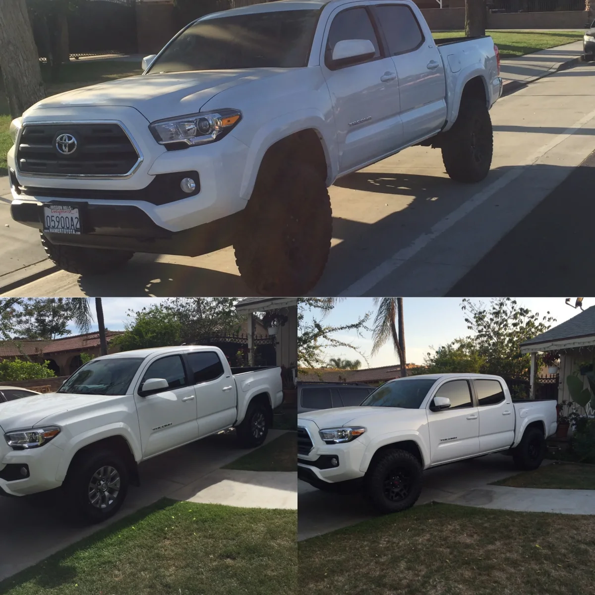

Installed ome kit on my 16 and got more than 3" lift out of it. Im running 285 70 17 duratracs and have no problems..
