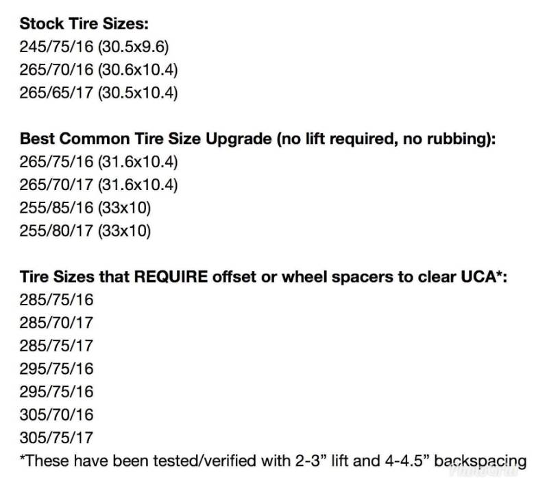

Thanks for the prompt response! What about 275/70/17 I didn't see that on the list. Does that require offset / wheel spacers and to that point is having an offset or wheel spacers have any downsides long term? Again this all new to me. What about rubbing?

After doing some more reading (again answers all over the board) I think I am going to go with the 4Runner TRD PRO Rims with 265/70/17 with KO2's, I think along with the Toytec 3" lift I shoudn't have any issues rubbing on the street and maybe some minor rubbing when wheeling if I REALLY stuff them. I mean according to the tire calculators the difference in height from 275's to 265's is .6 inches. Worst case I run the 265's, they look crappy I wear em out and get 275's or just sell the 265's used and take financial hit.

Yes that will fit in the space. The 4runner pro wheels are +4 offset and you could run 275/70/17 on them with the 3” lift and not have rubbing on road. You may have a little off roading though. Congrats on the new Tacoma. Welcome to the forum. Picture when you take delivery.
