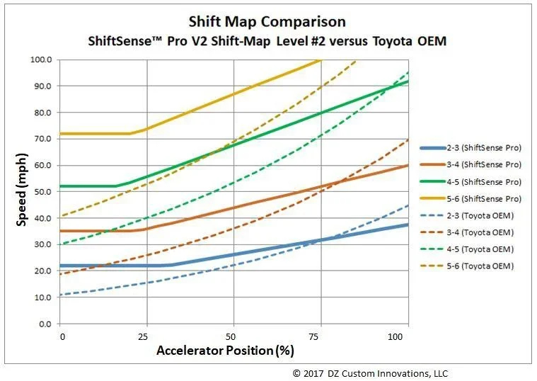

    Also, there is a device called the shift sense pro that puts the shift points at a higher speed range. The diagram shows our Tacoma’s current shift points and the difference after a shift sense is added.
    https://www.dz-custom-innovations.com/products/shiftsense-pro

    Just ordered the ShiftSense Pro V2. They provide some convincing videos. Lots of positive feedback from buyers on Tacoma World.

    $185 for the shift sense. $769 for the OV Tune. Agreed that overall the OV Tune definitely offers a more encompassing package but the Shift Sense Pro offers a quick solution to the issue almost $600 less.
    I haven’t seen many reviews for OV Tune. I’m sure their awesome though.
