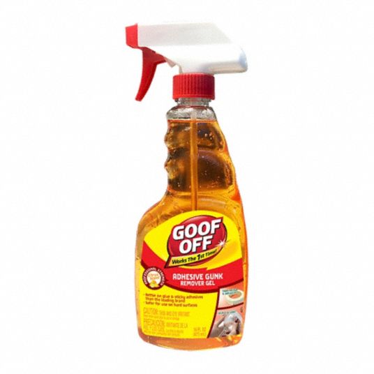

would this product work?

I wouldn't use lacquer thinner, or acetone, that'll take the clear coat right off. Maybe try some plastic polishing stuff like mothers with some elbow grease.

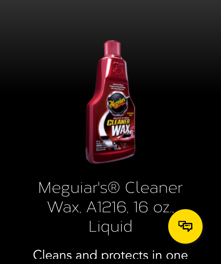

I think that stuff is like nail polish remover, I'd avoid it as could take your trucks paint with it. Maybe spray some paint on an old sheet of painted metal...let it dry a day and see if that stuff only removes the new paint.
Meguires makes a product called cleaner wax it seems to have the slightest bit is fine compound in it . Its was in a maroon bottle at advance auto I have some and I use it with my big buffer .
Careful with that stuff. It is a weak rubbing compound. It will remove clear coat.
I used it to take the nasty duct tape gluey film off my trucks newly coated frame areas
Duct tape used to cover holes in the frame
Worked well but took some time and scrub scrub scrub
