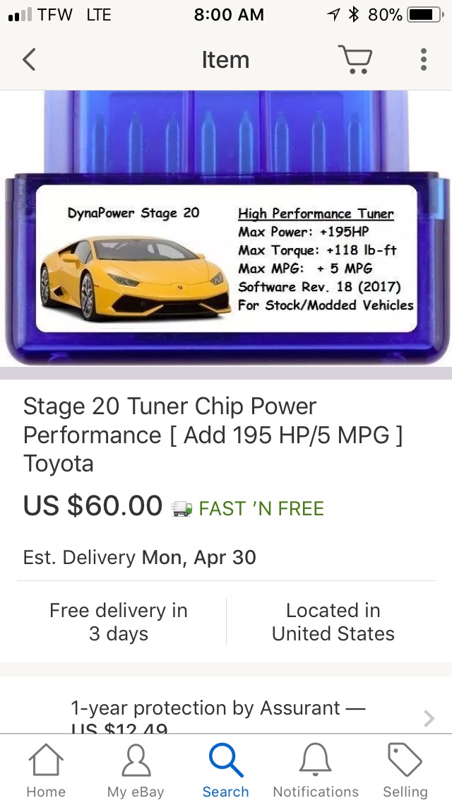

Performance Chips gentlemen ?
Speninja
The seller states this will fit on any vehicle including Tacoma’s of my year model (2015). Is this too good to be true ? Legit ?
Just an FYI, unless you are running forced induction, a “chip” or “tune” will never result in any more that a 5% increase in power (and even that is being generous!).
Chips are only going to help with the tune, if you have potential hidden power, then they will work. Most won't really do much as the factory has already set up the motor for best mileage and performance balance.
The stock 2nd gen runs super rich... there is up to 15hp hidden there on the v6
Dont use these worthless ebay piles of crap tho.
The cheapest option THAT WORKS AND ALLOWS YOU TO FINE TUNE is the urd maf calibrator. It does so by allowing fuel adjustment, mainly in open loop.
If you want more info, contact urdusa.com

I wasn't aware of this. Good info, thanks jangley
