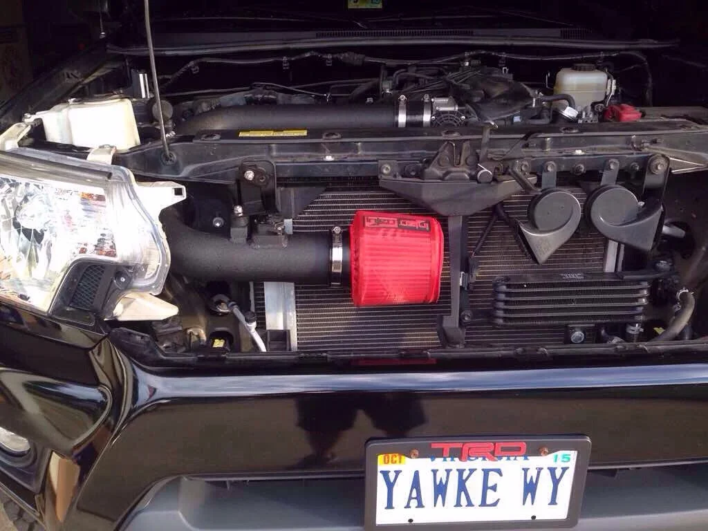

My truck came with the TRD exhaust. Then I added the URD CAI and MAF calibrator. Big difference in response. Added a couple MPG on the Hwy.

Not sure what a URD CAI is. MAF calibrator regulates the amount of air for the MAF? What is the cost for this?
Thanks for the URD website. Looks like a cold air intake is what I need. I am really looking for low end torque. With my oversized

The throttle response is better. I tend to scare people who have their window down when I get on it. It does rumble. If you add the calibrator and tune it you can squeeze almost another 20HP out of it.
Went on a few websites and looks like most CAI are not doing much or anything for lower RPM torque. Everything seems to be above 4,000 RPM. Minimal gains even there. K&N CAI adds maybe 8 HP at over 4,000HP and showed nothing at lower RPM. Also not legal in California since it won't pass smog.
