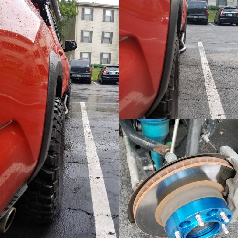

I kept the stock rims and used Spidertrax spacers. 10000 miles and no issues at all. Just check torque on them every tire rotation.

Just remember the way your tire sits will be different with spacers meaning the position it will be at, hence how big your tires are, what wheels you are running, what suspension you have and what weight you have will impact how your tire works in the new position (meaning rubbing issues)
Thanks. I have after marker wheels, but all stock sizes so I shouldn't have any rubbing issues. I hope.

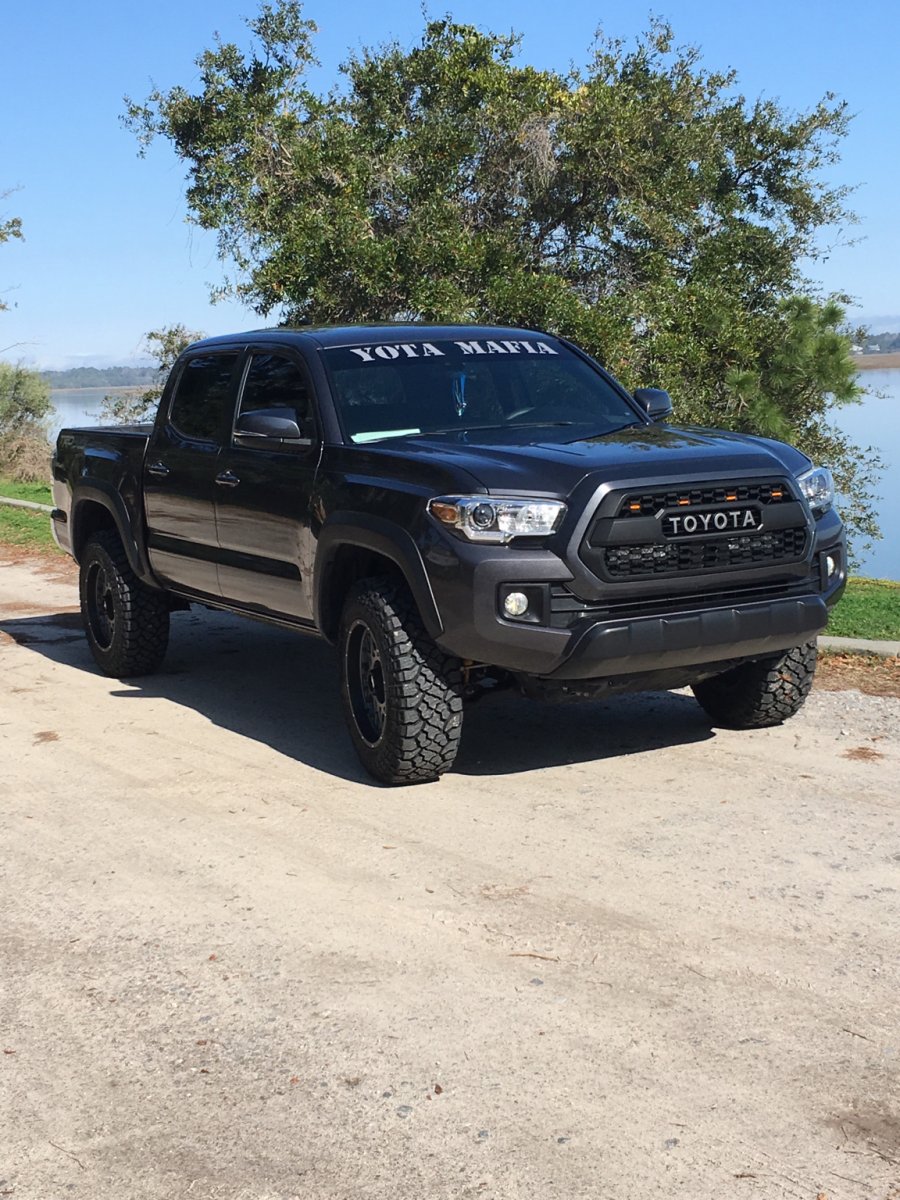

I took my wheels and tires off with 300 miles on them. Bought aftermarket wheels MB TKO 16x8.5” -6 offset ($110 ea.) which helped fit BFG KO2 285/75/16 tires. ($188 ea.) Got the entire set up through discount tires for $1270 (installed) after rebates and presidential day discounts came to $1020 Sold my new off-road wheels and Kevlar wranglers for $850 bringing my total for wheels and tires I wanted to $170 out of pocket.
