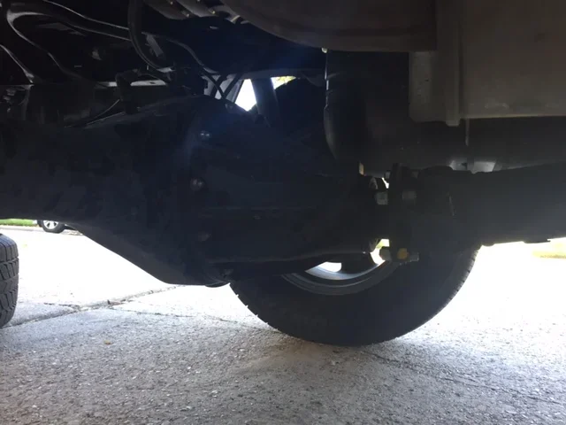

I just noticed the same problem on my 2016 TRD sport with 5,500 miles. It started vibrating when I slowed down, usually between 40-20mph. I looked underneath and noticed that it is leaking differential fluid. It will be going in to the shop on Monday, fingers crossed they replace it since it has been running low in differential fluid for a little while.
