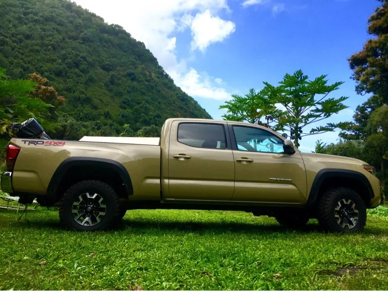

Was wondering if anybody has experienced there rear tires to lock up completely almost like the parking break was on but it was only in 4 wheel high . Was locked up for about ten minutes untill I put into 4 wheel low then it made a loud banging metal sound in the transfer case and it finally unlocked and i was eventually able to move without dragging my locked tires . I also noticed transfer case making lots of random banging sounds when I stop or take off the 4 wheel drive . I have a 2016 Trd off road extra cab crawl control
