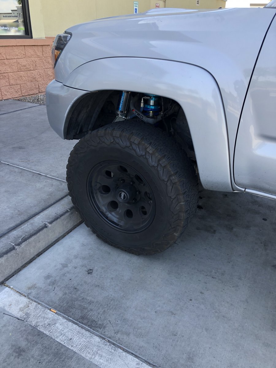

    How much do you all run on the road? And how much off-road? I’m running 35psi on 285/70/17 for road. Hope that’s okay. IMG_5100.jpg

    I do 38-40 front and 35-37 rear on hwy. Same size.
    Good wear, good mpg's.
    22-25 if you know you'll be off road for a few days and can air back up before you go home.

    I get the best tire wear at 37psi with my Mickey Thompsons.

    Chalk test will help.

    I’m gonna try that thanks man!!!

    I run 40 in my hankook 265-70-17. Get 21-22 on highway and its not bouncy on bumps around town .

    I ran the same on my 285/75/16 KO2’s and on my 275/70/18 GY wrangler DuraTrac’s

    I run 40 psi on 285/70/17 AT's

    And rotate every 5k !
    I run 17 psi on the beach .
