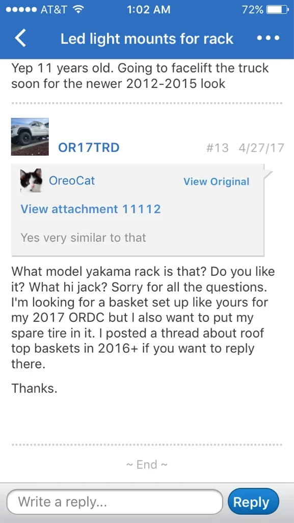

I've been looking at roof mounted cargo baskets for my 2017 OR DC. I have the factory cross bars. There are so many options out there. Thule, Yakima, Rage, Rhino and the list goes on. Not worried about price. I want quality and something that accessories can be easily added to like a tire mount. I was hoping to get something I can put a spare tire in size 285/75/16, mount a shovel, ax, hi jack and still have room for a chainsaw and a box/cooler or some camping/hunting/fishing gear if needed.
Any one have this set up on their DC?
Brand? Size? Pictures? Likes/dislikes?
Anything helps thanks.

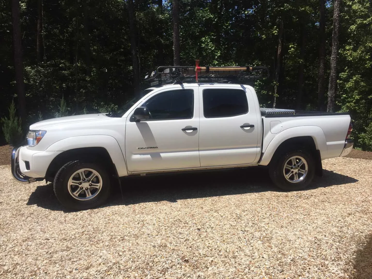

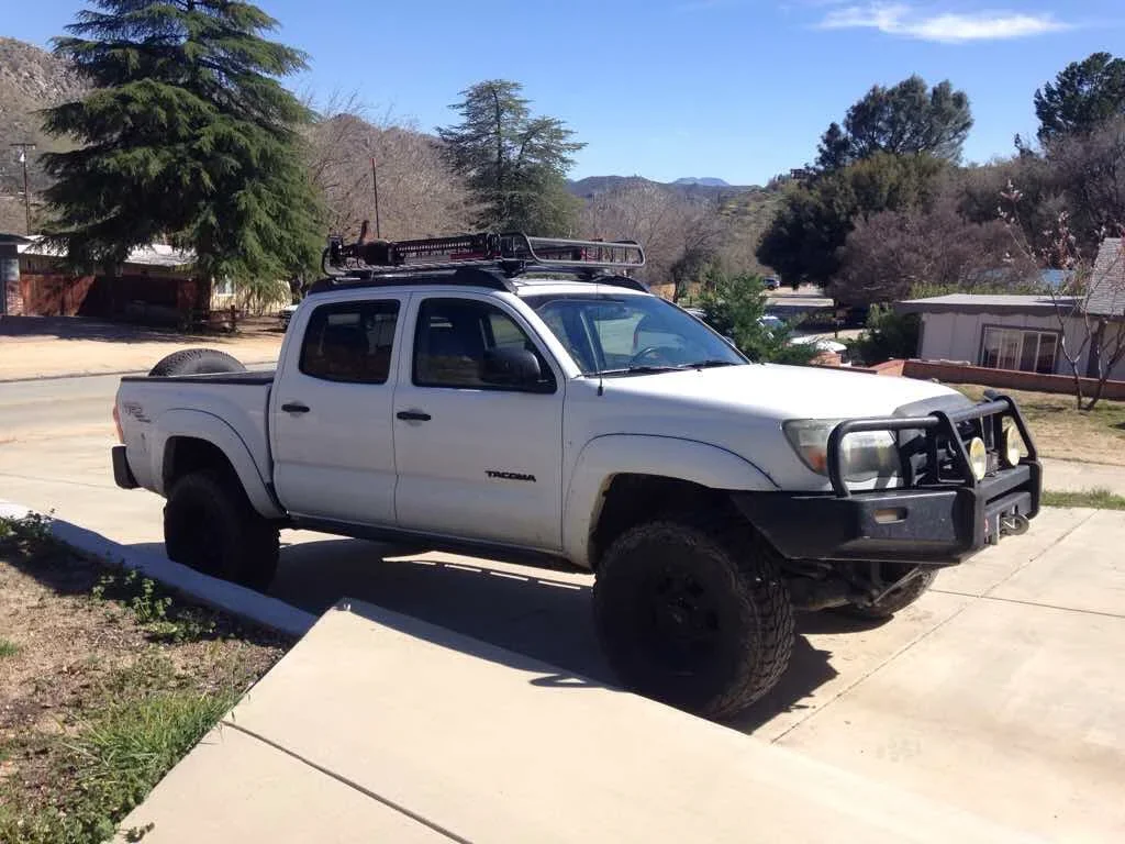

Mines oem roof rack with a Yakima load warrior (with extension). I got the truck with the shovel and hi lift, but the high lift mount can be moved around so I think any highlight brand with the correct mounts will fit
Putting a tire up there is probably going to be pushing it with weight. I'm only going to use it for light stuff. Also the high lift rattles and is extremely annoying. ImageUploadedByTaco Forum1493712449.325599.jpgill try to get better pics tomorrow

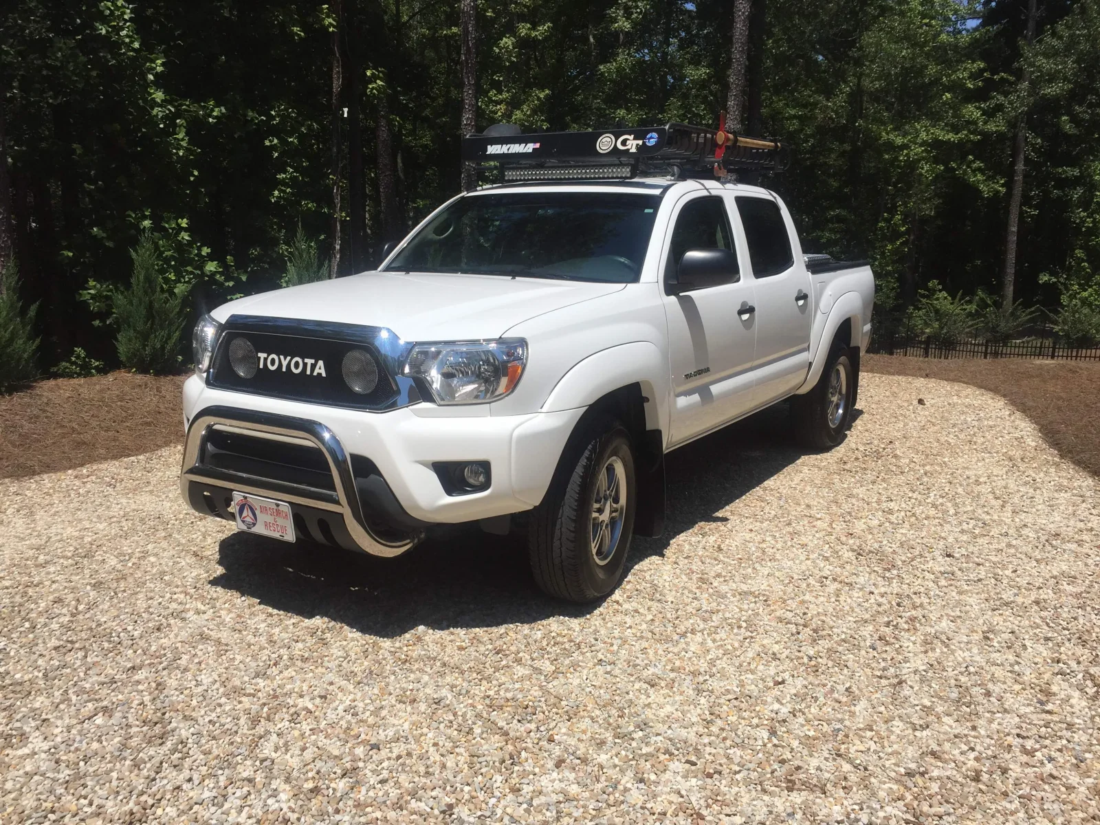

IMG_5602.jpg. I bolted mine to the roof using Yakima landing pads. Makes it easy on/easy off with a life in the garage only have to raise it six inches to clear anything. I have the mega warrior full size with one extension, two axe/ shovel brackets, 8 load stops, big light bar wires to the front and a small one in the back for stadium lights in the bed since they decided no one wanted to see in their bed after dark. The landing pads are thru the roof and backed up with nuts and lock washers inside. I get a lot of people stopping me to ask about it at the gas stations. I have had 300 pounds up there and it works great. I install large av systems and live sound for concerts. I had a pair of JBL double 18 bass bins on top with a few flight cases. We also sit on top when there is a parade or fireworks to watch. I've had this rack on two tacomas and two grand Cherokees. It has held up great. It really hasn't started looking faded or old. They make some good stuff at Yakima. Look into the landing pads and the mega warrior. I'm adding two more extensions when I get a camper shell to run it all the way to the rear of the truck. It's gonna be stupid long but why not?
Well here is a better pic from the side. It hangs past my back window but it's great for leaning truss bars on to keep it far away from the roof. And I can strap stuff to it that's pushed close to the tool chestIMG_5601.jpg
