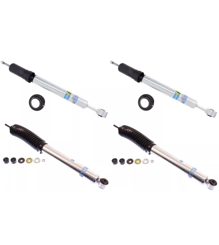

    kp.taco what is the best struts and rear shocks to replace the factory ones with? No lift.. stock
  6. Bojangles
    Bojangles Well-Known Member
    Bilstein 5100s
    Leave at zero lift if u want...
    Cheap, and lifetime

    When I replace mine it will be 5100s like @Bojangles said.

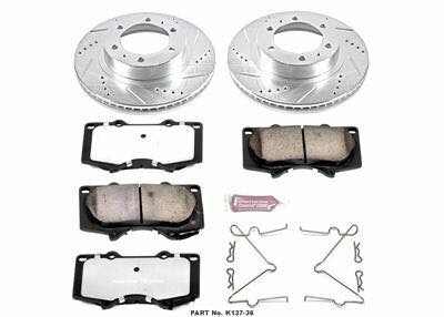

    Don’t know if you have checked the rotors yet but that was my problem

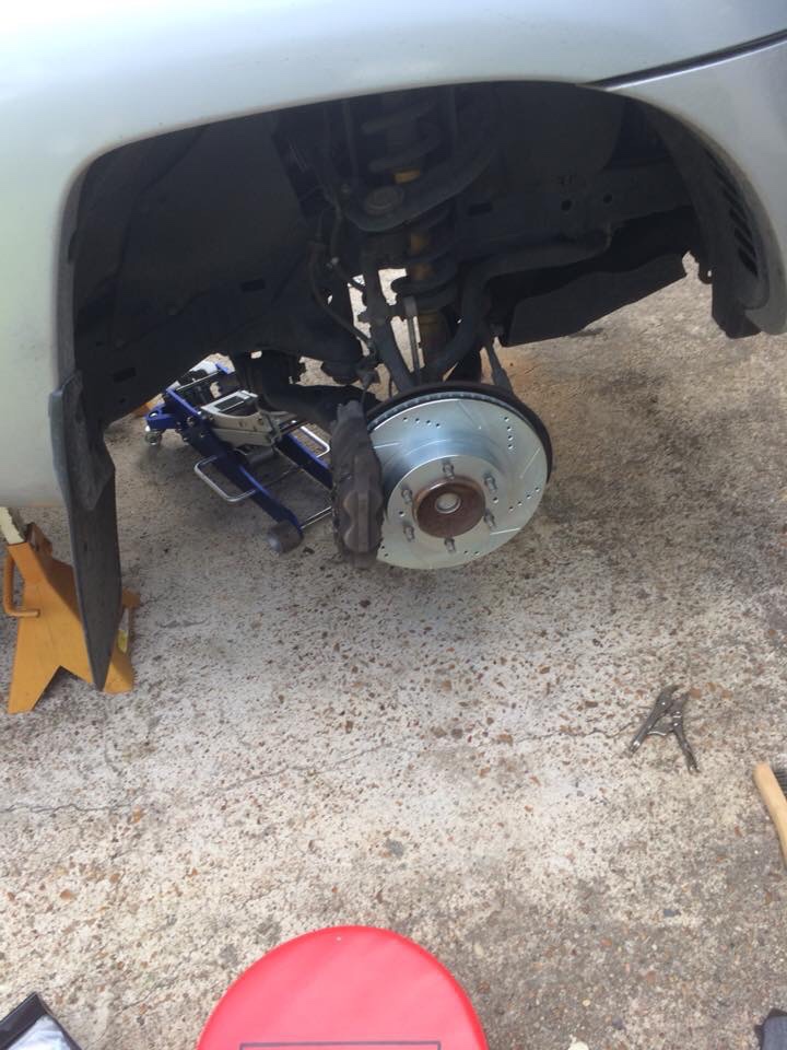

  20. dwayne.surrat
    dwayne.surrat Well-Known Member
    Mine was doing the same thing I replaced the rotors and it stopped IMG_4385.JPG IMG_4384.JPG
