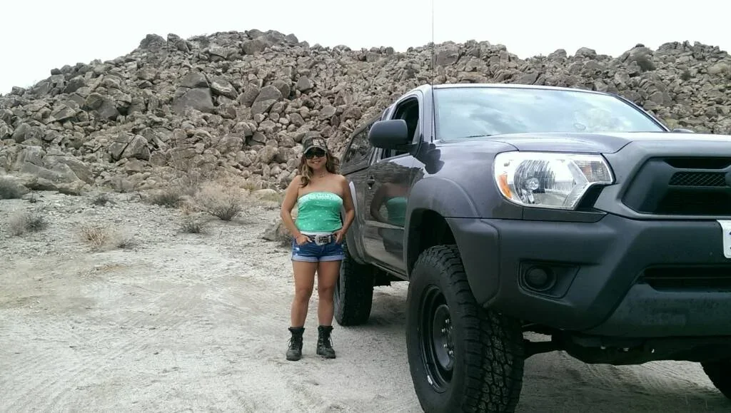

I put a 3 inch old man emu (ARB) with 33s (285/70r17) and reheated to 4.88s. I have a 14 ref cab 4x4 with an automatic trans. 2500 rpm at 70mph. I chose G2 gears with ARB air lockers.
