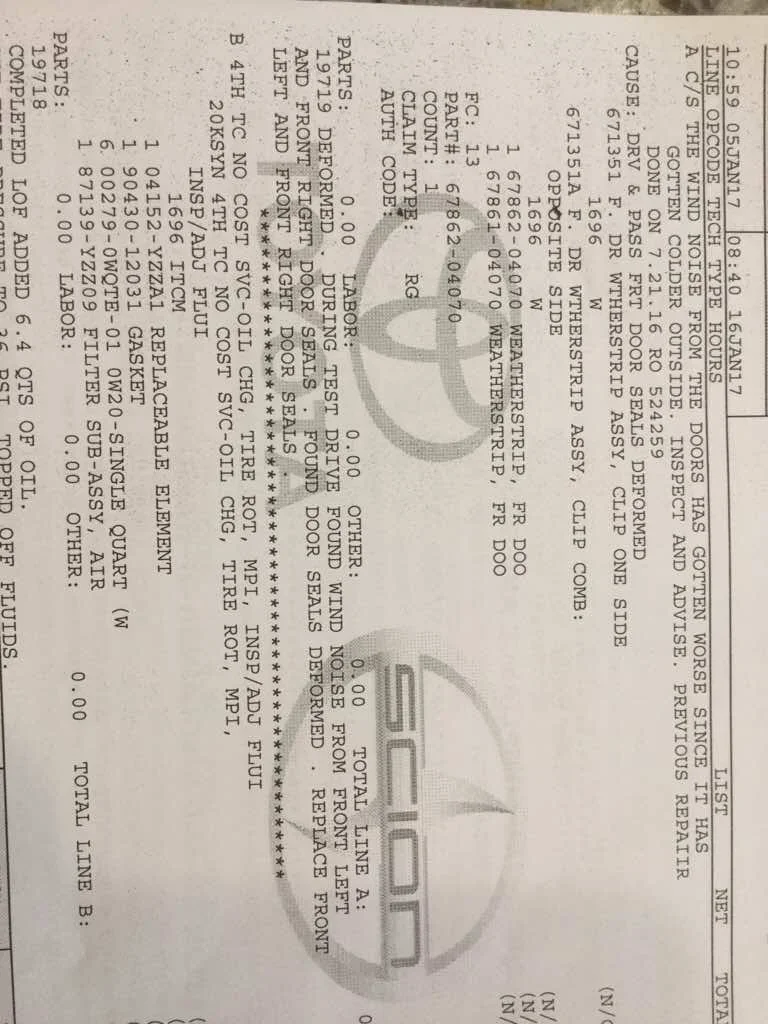

I have 2016 4X4 Access Cab. I get 15.8 mpg combined. Along with poor mpg is the crappy Entune App on my Samsung S5 and a really bad wind noise from the doors that the dealership says is the ports to let air into the cab. Three issues. Poor mpg, wind noise (Toyota should fix these) and a bad app.
I had the interim fix applied and it helped a lot with the wind noise. Today they applied the complete fix as is installed on the 2017 Tacoma. They replaced the front door seals and replaced the rubber windshield side moldings with a plastic molding. We will see if it solves the reed type noise.

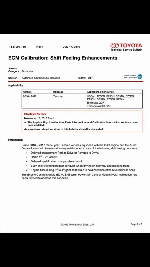

I hear that! I chose a 2015 TRD Sport strictly because of the engine. I think Toyota really messed up putting in a 3.5L after the 4.0L proved itself year after year. My buddy's 2017 was shifting all over the place and was driving him crazy. He made several trips back to the dealer, and all they did was check the fluid level. When that didn't help, they drained the fluid and replaced it. Still didn't help. I checked with my local dealer, and they had received a service bulletin on that very problem. He told that to his dealer, and they said they knew nothing about it. He had them check with Toyota, and sure enough, they were informed of the bulletin. They ended up ordering a new chip for his transmission, and it made all the difference in the world. Amazing what you can learn from one dealer to another.
I am having a similar battle they did an update for the transmission but it did not fix the issue. Is there anyway to get more info from your friend about this chip for the transmission. My local car dealer a bunch of "D" Bags and they love telling me they don't have a fix and call corporate about it. I actually tried to have corporate consider my truck a lemon has it does not run how it should. I would love to get my transmission issue fixed since they are not going to take it back. Any more info would be greatly appreciated!!!
I just know that after I found out from my local Toyota dealer that there was a service bulletin on this issue, he asked his local dealer, and they knew nothing about it. He insisted they call Toyota direct, and that is when they ordered the chip for him. I am not really sure whether it is an actual chip that you install, or a chip that has the necessary info on it that you download. Either way, I would not let an authorized dealer tell me they don't know or they have heard nothing. Make them call Toyota, or do it yourself. Good luck...
