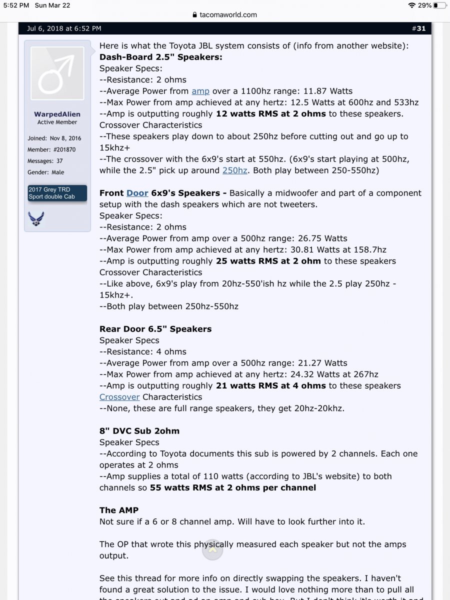

I know the JBL systems have a amp but I think it’s only for the subwoofer. Someone know otherwise?
The amp is for all the speakers. The only way to upgrade the JBL from what I’ve read is to replace everything. You’ll need all new speakers, new amp, etc. Don’t think it’s hard it’s just costly to basically buy new everything. Mine is plenty loud, it just doesn’t sound good. I wonder if you have an issue with the amp not getting power to your speakers. Might find a fuse for it and check. Unplug the fuse and see if it sounds the same or check the fuse with a meter.
