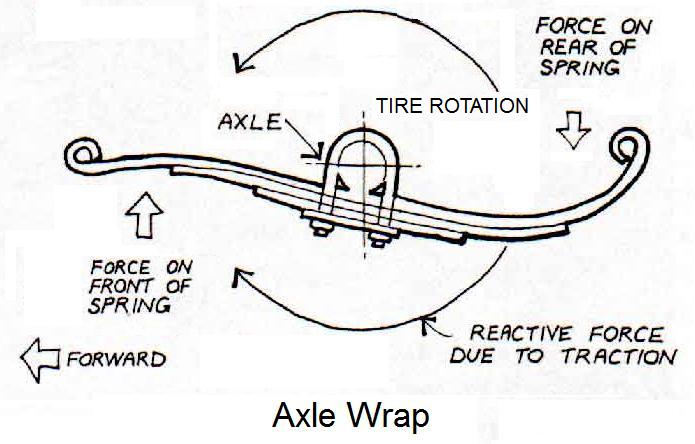

Axle wrap described to me is the torque of the engine to the rear drive shaft and diff overcoming the springs and twisting the axle during acceleration sometimes resulting in a 'clunk' when stopping.

I've read here on the forum that stronger updated springs help alot. I've chosen to live with mine. However, the noise you hear may have nothing to do with the axle and is something else.

Without hearing or feeling what you’re describing I would not be able to say exactly but it does sound like you’re experiencing the bind and release of the rear axle and leaf springs known as @kp.taco wife put it asshole wrap.

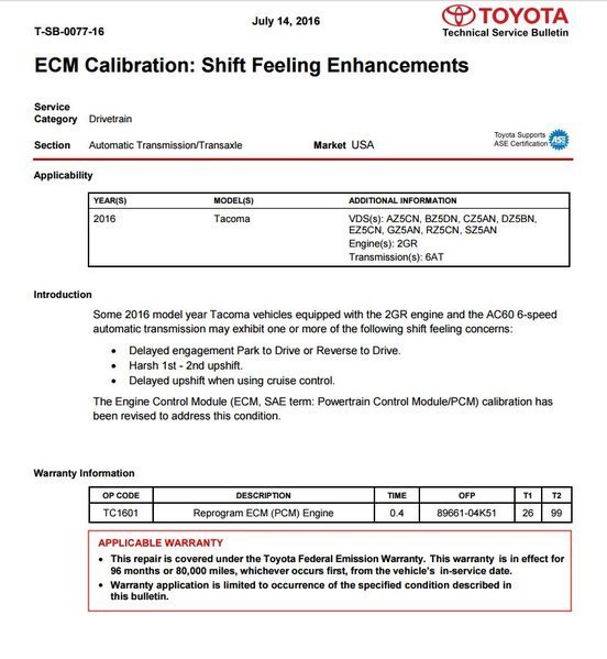

There was a hard shift TSB from R to D. I thought they got it fixed in 2017 and haven’t heard any 2018’s having the issue. Maybe that TSB needs to be completed?
