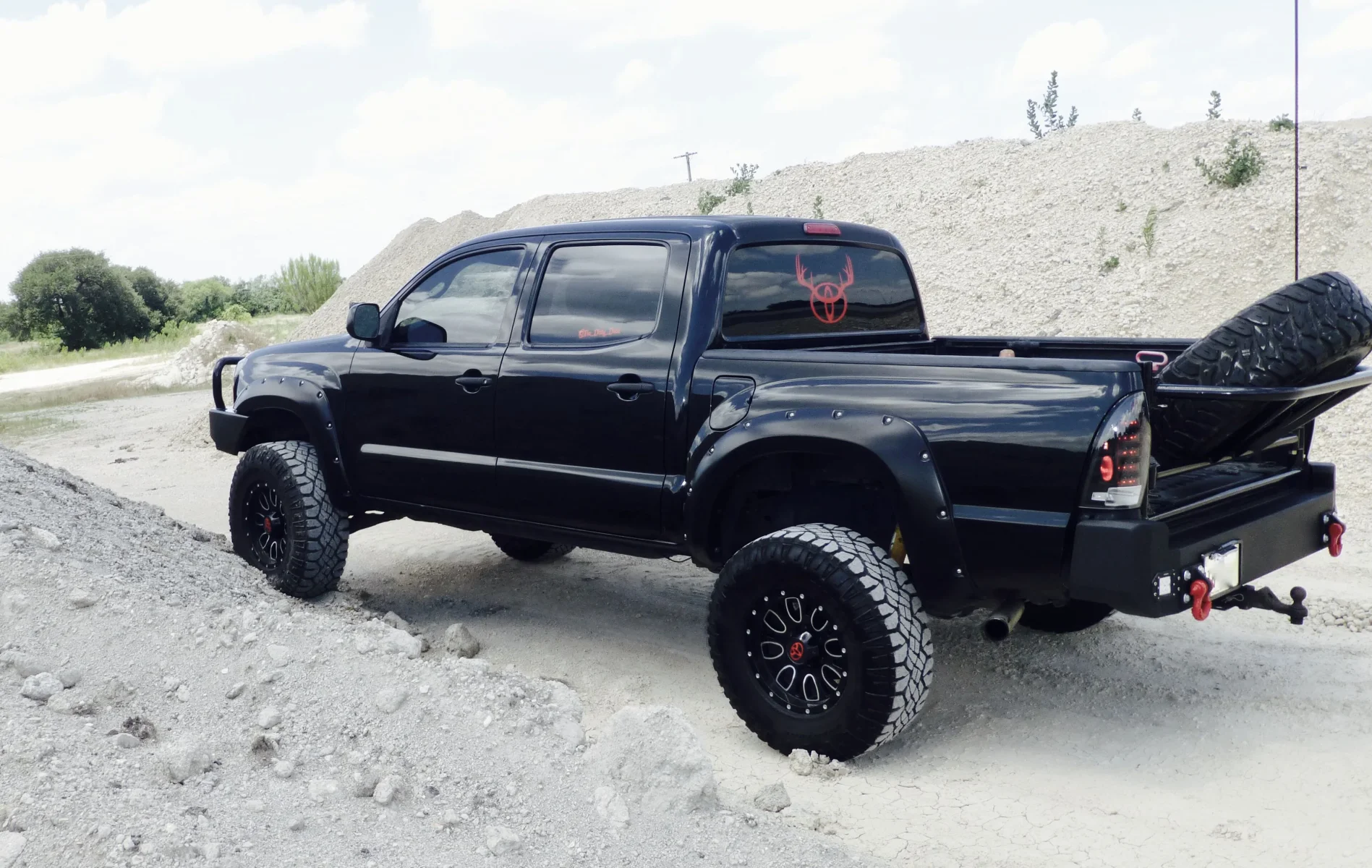

You're on the right track! Suspension lift is the way to go, I have a 3 inch Old Man Emu suspension lift on my taco and it's great! Haven't had any problems for 3 years now. View attachment 11946
I thought OME lift kits only go to 2 1/2" ?
With the optional trim packer on their struts, or 1/4" spacers on 5100s they give 3" if i remember correctly?I thought OME lift kits only go to 2 1/2" ?
Depends on the kit and the gen. Gen 3 is an inch taller at stock height so the same lift that would lift a gen2, 3" will only lift a gen3, 2" from stock height.I thought OME lift kits only go to 2 1/2" ?
Hmmm then 3rd gens don't come with the same coils as the 2nd gen?Depends on the kit and the gen. Gen 3 is an inch taller at stock height so the same lift that would lift a gen2, 3" will only lift a gen3, 2" from stock height.
Nope.Hmmm then 3rd gens don't come with the same coils as the 2nd gen?
I haven't heard anything about that... I got this lift over 3 years ago so maybe they don't make it anymore? But my lift is 3 inches so far
There are different springs you can get with the OME lift that will vary the lift. Any extra weight up front will also impact this too of course.I thought OME lift kits only go to 2 1/2" ?
