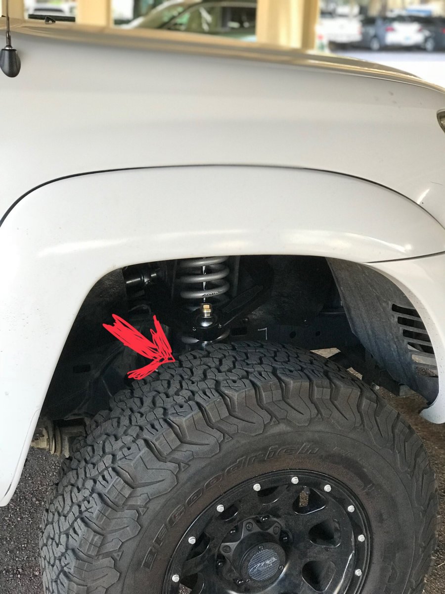

So I recently installed Bilstein 5100’s/toytec coilovers up front with a true travel uca.
Now my uca is hitting my coil during down travel, how can I fix this or stop it ?
Thanks
I did some research and it seems you can try turning the coil but it could also be a problem of too much lift. A different arm may have more clearance but it may not solve the issues. Yes arms as in upper control arms.
Won’t have money for new uca for a while haha just got these and there not cheap
Do you think limit straps could work ?

I was thinking “too much lift” as Nancy said above. You probably got almost 4” of lift, right? Can you move the clip down a notch? Or is it on bottom already?

It’s not on the bottom clip, might try that eventually but no money or time to mess with it at this point
