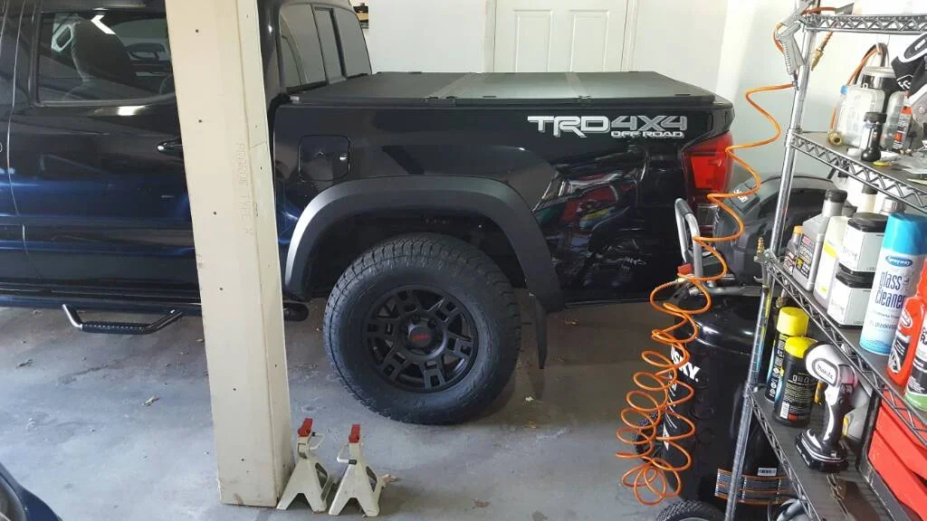

I have that exact wheel. You cant get a 265/65R17 mounted on a 17x7 wheel as its only 7 inches wide and that size tire requires 7.5inch. Butttttt. You can put 265/70R17 on a 7 inch wide wheel. And your wheel diameter will be 1 inch more than stock. Small speedometer issue with 2-3mph diff at 75mph. So 72 on speedo means 75mph actual due to larger diameter tire than stock. I have stock suspension. No rubbing issues. 20161226_140747.jpg
Funny how 4wheel parts leaves out wheel width requirements for that tire size. But i know its 7.5inch. I went through this drill already. Lol
I have that exact wheel. You cant get a 265/65R17 mounted on a 17x7 wheel as its only 7 inches wide and that size tire requires 7.5inch. Butttttt. You can put 265/70R17 on a 7 inch wide wheel. And your wheel diameter will be 1 inch more than stock. Small speedometer issue with 2-3mph diff at 75mph. So 72 on speedo means 75mph actual due to larger diameter tire than stock. I have stock suspension. No rubbing issues. View attachment 10687
Cool thanks.
