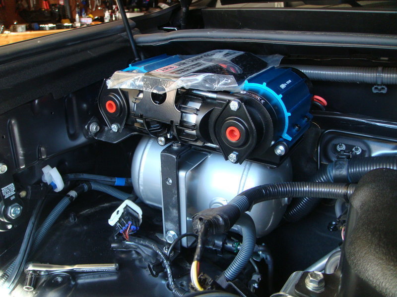

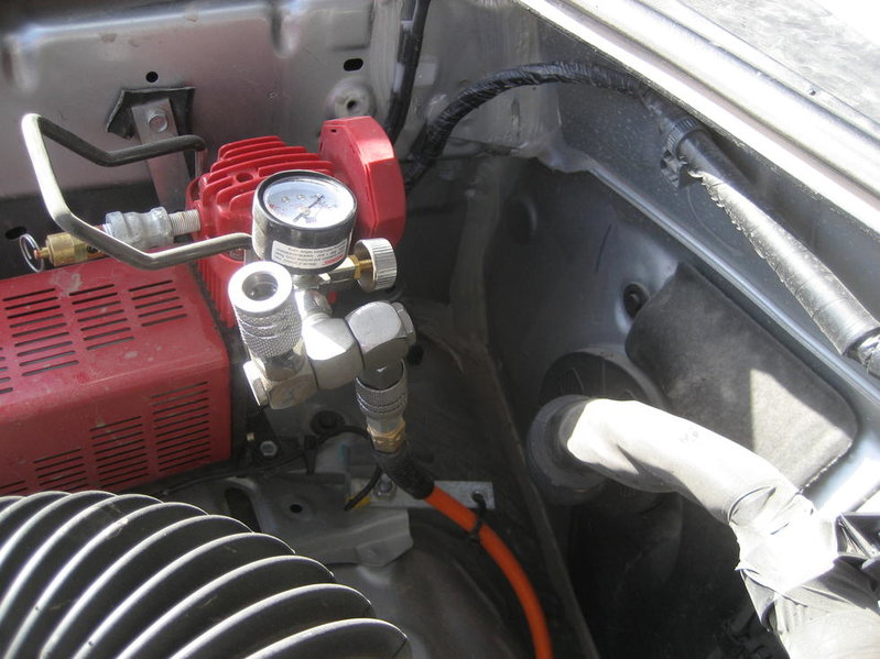

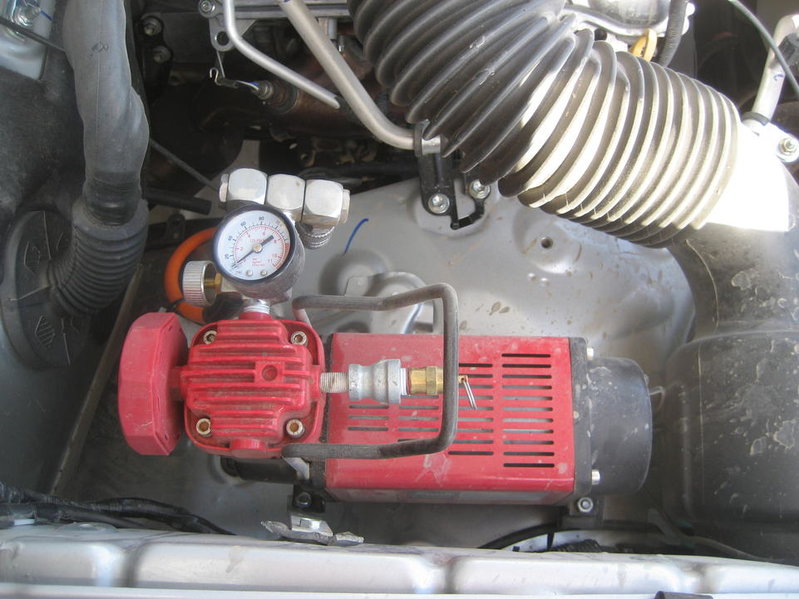

I've seen people use those mounts for air compressors, aux fuse boxes and 2nd batteries. The possibilities are endless.
