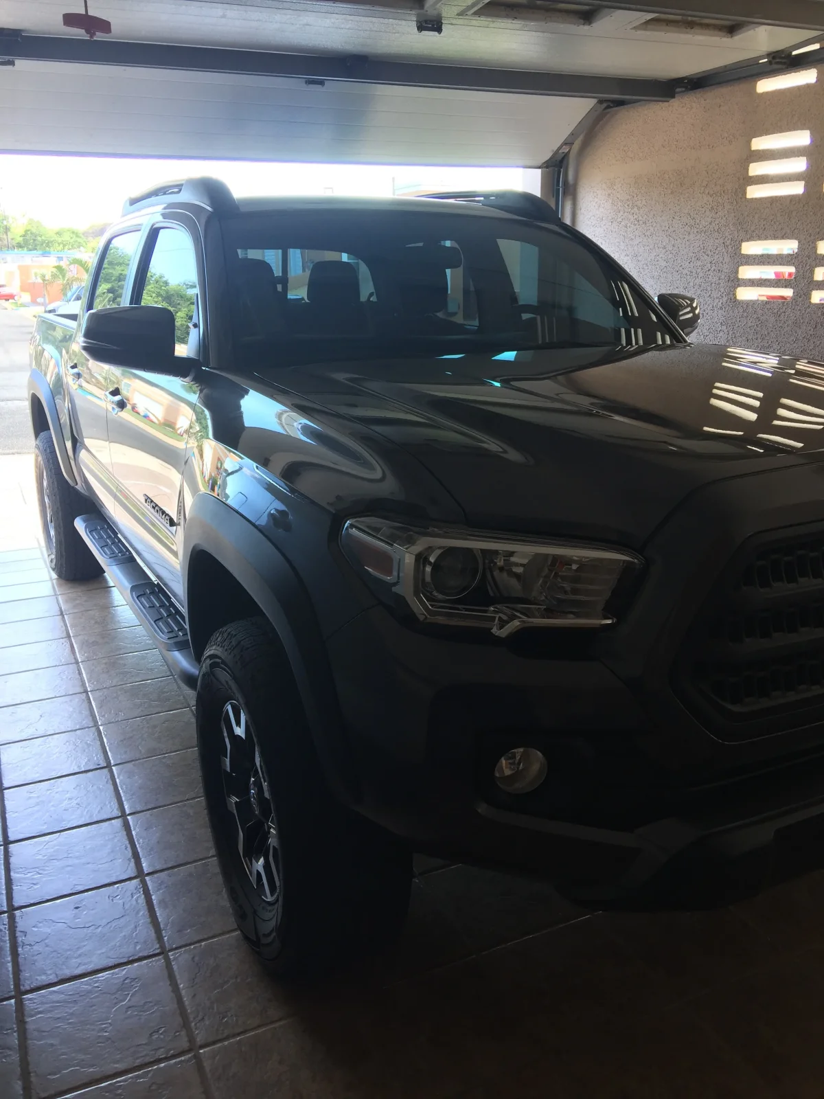

    Trd offroad 4x4 ,wheels spacer,magnaflow exaust,mate black embleme and stikers,shift sence pro,Trd air filtre, Soon front rouch country leveling kit

    I just want to level the front a bit so this is the same as the back

    You can do that by replacing the front shocks with bilstein 5100’s and setting them so it’s level. Done and not junk.

    very good suggestion

    Also if you want to lift it more later you can buy the 5100’s for the rear with a 1.5” AAL and adjust the front 5100’s to level it out. You’ll get about a 2” lift. If you want more get OME 887 coils put the front bilsteins back to the lowest setting. Get a 2” AAL for the back or buy the Dakar leaf pack. That will put you at about 3” and can run 285/75/16 with a 0 or -6 offset wheel or wheel spacers on stock wheels.

    that's what I want later to mount bfg 285/75/16

    On a budget that’s the way I would go you can do it in stages as funds come in for mods.
