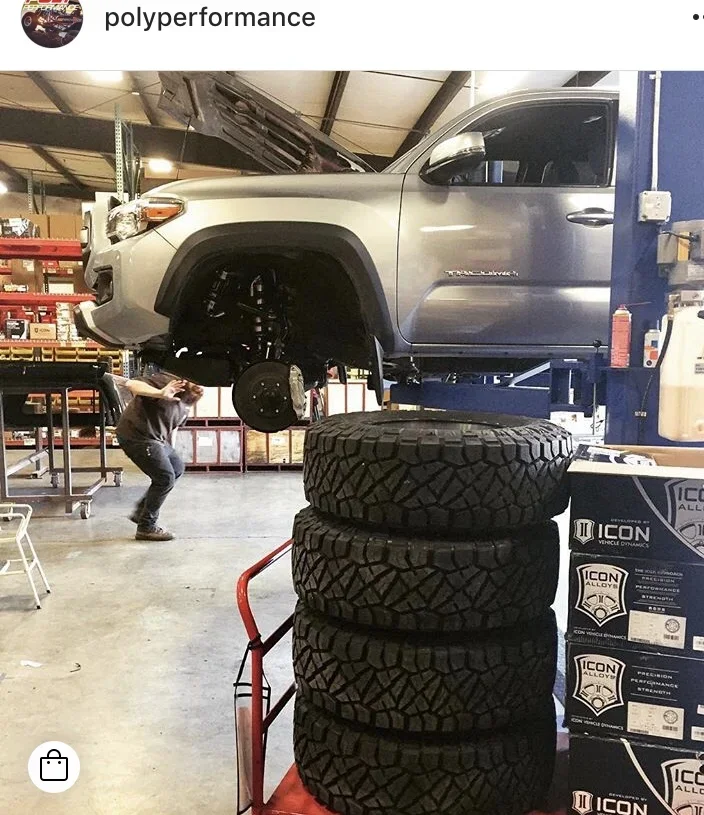

    Here we go
    OR17TRD likes this.
  14. OR17TRD
    Woot woot!! Exciting. Love the sound and smell of new rubber rolling down the road.

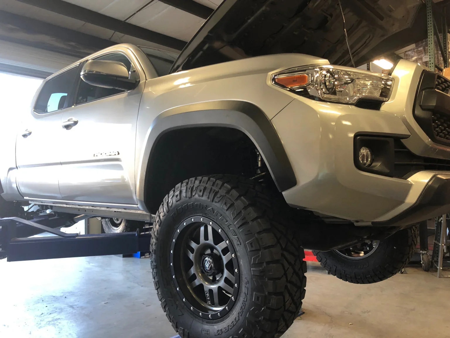

    Grovertaco
    Grovertaco Member
    IMG_2115.jpg had to do the cab mount chop shop keeping it over the weekend ... can’t wait
    JonRod, OR17TRD and Bogunn like this.

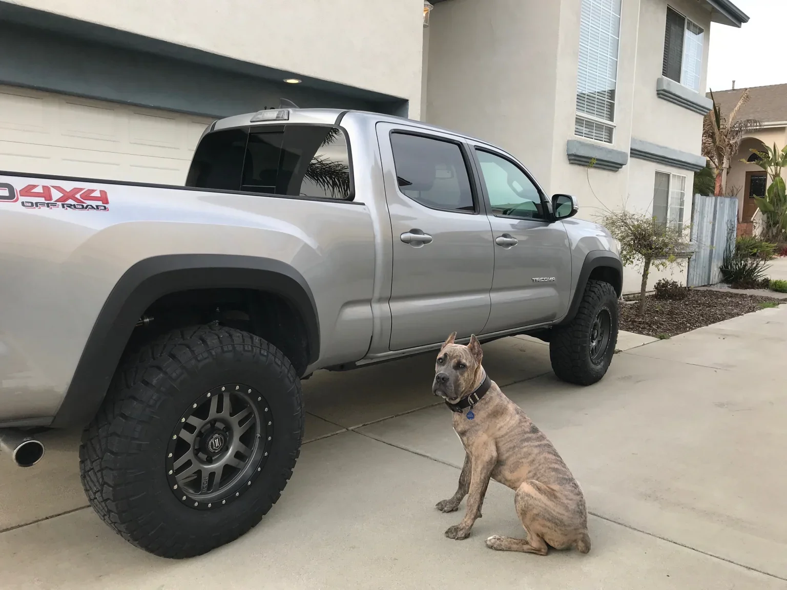

    Grovertaco Member
    Icon stage 4 and icon wheels with 285 75 17 Nitto ridge grapplers . Rides so much better and no effect on mpg that I can tell
    J.R., Bogunn and OR17TRD like this.
  17. OR17TRD
    Looks great. Just wait you’ll notice it degrade. :(
    Gorgeous dog.
