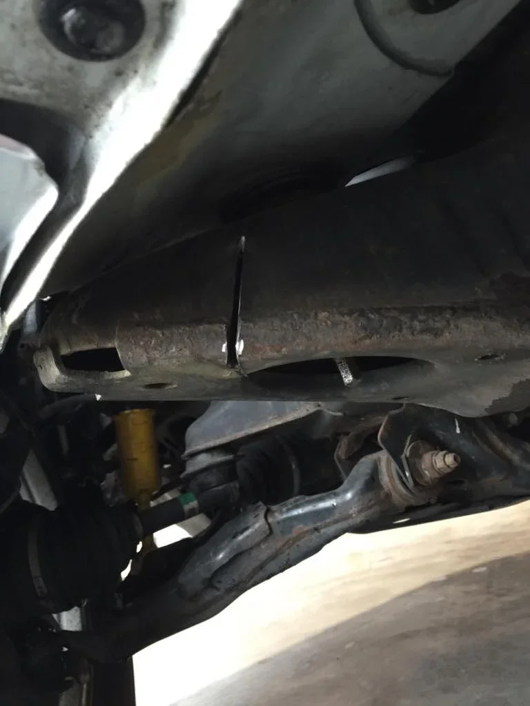

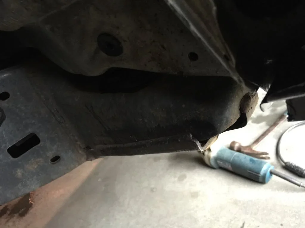

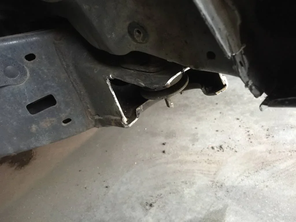

Wheel spacers or changing the rims increasing the back spacing do the same thing. They move the inside of the tire away from the UCA. Even with an expensive 3" lift and 285/70-17 or 285/75-16 you'll hit the body mount! BMC is what's needed . I had to do this on my 2010 FJ Trail Teams and on my 2007 Taco double cab. I put 188,000 miles on the FJ. Wheeled it in many situations with no problems. No frame twist, nothing changed the ride concerning BMC.ImageUploadedByTaco Forum1426752892.030602.jpgImageUploadedByTaco Forum1426752954.939398.jpgImageUploadedByTaco Forum1426753321.837434.jpg
Wheel spacers or changing the rims increasing the back spacing do the same thing. They move the inside of the tire away from the UCA. Even with an expensive 3" lift and 285/70-17 or 285/75-16 you'll hit the body mount! BMC is what's needed . I had to do this on my 2010 FJ Trail Teams and on my 2007 Taco double cab. I put 188,000 miles on the FJ. Wheeled it in many situations with no problems. No frame twist, nothing changed the ride concerning BMC.View attachment 5140View attachment 5141View attachment 5142

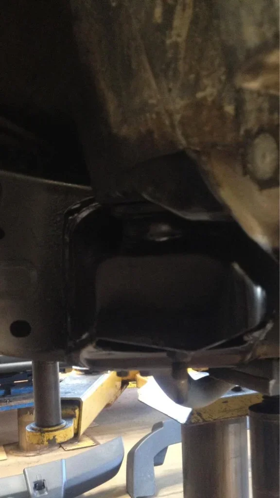

Once you cut and weld some plate steel back onto the body mount it'll look similar to mine. Paint and it will still be supportive and strong.
