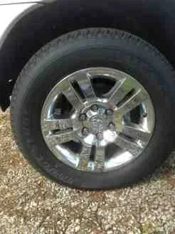

I have a 2013 Tacoma, V6, LB, 4x4, Limited. My tires are Bridgestone Dueler H/T. P265/60R18. The sticker on the door says the tires should be at 29 psi cold. The dealer had them at 35. I think it's best to keep them as the manufacturer suggests. Am I right? ImageUploadedByTaco Forum1371157330.900946.jpg
