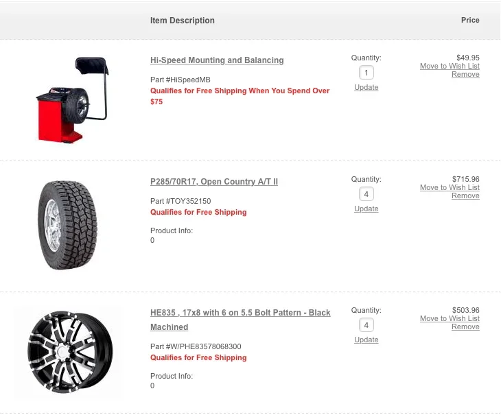

I am going to buy wheels and Tires from 4wheel parts and I'm going to have them balanced and all and sent to my house so I can install them. Does anyone know anything about the PSI sensor and what I have to do for it to still read with the new wheels. Thanks for the help
It needs to be reset. There is a button under the dash on the left side. Don't know what else it entails.
Discount tire will make sure it works for just a few bucks.
16' TRD Off Road DCLB Inferno
If you buy new sensors in the wheels, you will have to take them to a tire shop to have them programmed. The TPMS button only resets the light if you change the pressure you want. It doesn't reprogram the new sensors.
