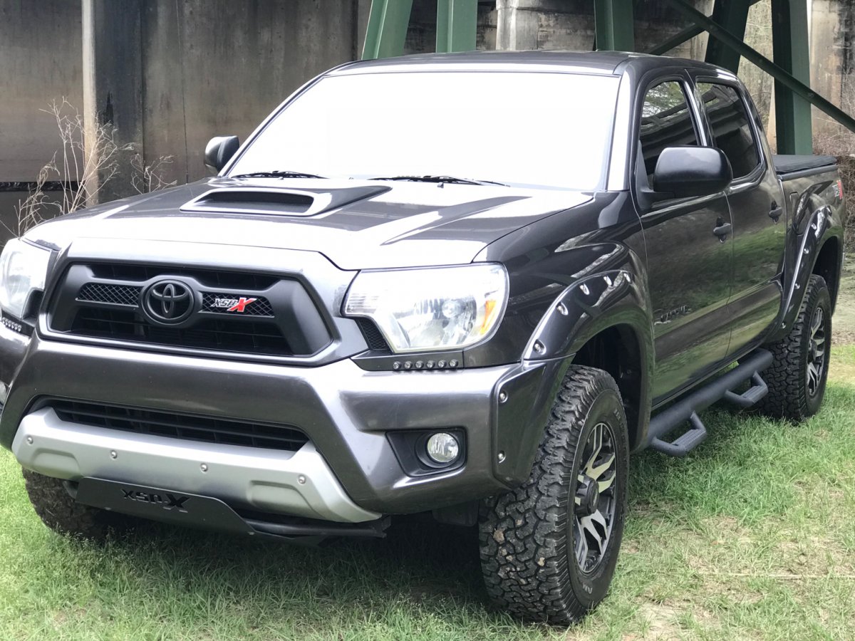

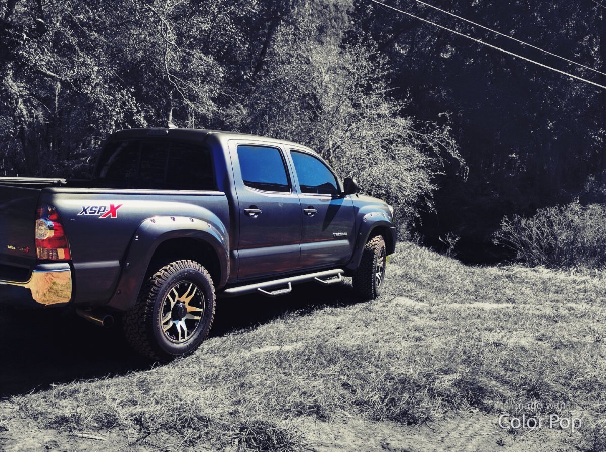

View attachment 17200View attachment 17201

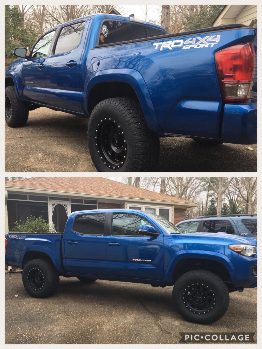

Here is my truck. I pretty much have a “Mall Crawler” since I live in a city with nowhere to 4 Wheel. I have the Toytec 3” level spacer and 1” block. Most guys on here are not big fans of that lift, but it has been fine for what I need the truck to do. The rear is a little low, so I may end up putting a 2” block in the back. It rides like stock and I have 285x70 on it.
You have to trim at all?
Please don’t do a spacer/ block lift. The 5100’s seem to be a great, lesser expensive option. I have not used them personally, but several guys on here, who’s opinions I respect, speak well of them. I have, however, used the Dakar packs. They served me very well and I have no doubt that you’ll be happy with them. There’s also nothing wrong with the AAL. I have also heard good things about the progressive AAL and may use it myself soon.
