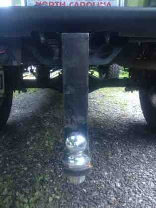

I bought this Reese from Advanced Auto for $119 plus tax. Got a 15% discount from online price of $149. Had it delivered there and then just picked up. Wasn't to hard to install by myself. Bolted right it. Rated 5000 lbs.
