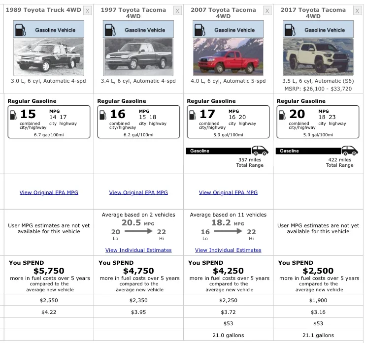

I’m all for lower emissions but let’s not fool ourselves these trucks never have got great MPG and all they are doing is gaining 1-2. My 1987 4x4 extra cab 4cyl 5spd got 18mpg in town and 21mpg on hwy. 2017 4cyl 6 spd gets 19 city 23 hwy. How far we have come.
