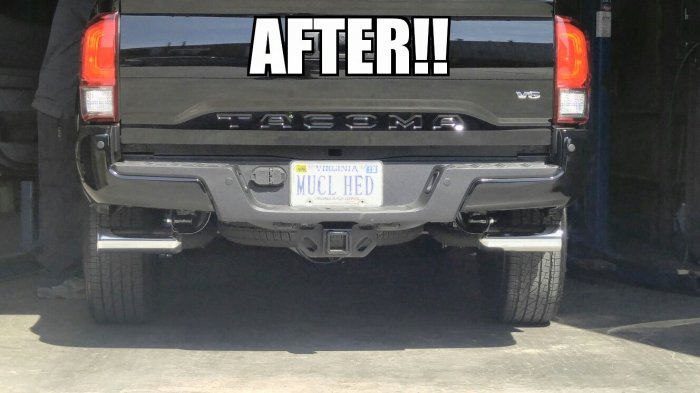

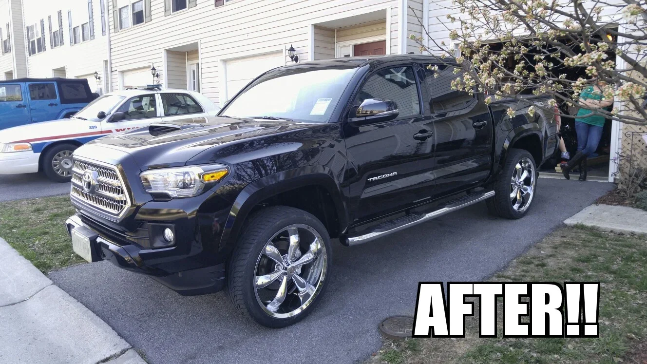

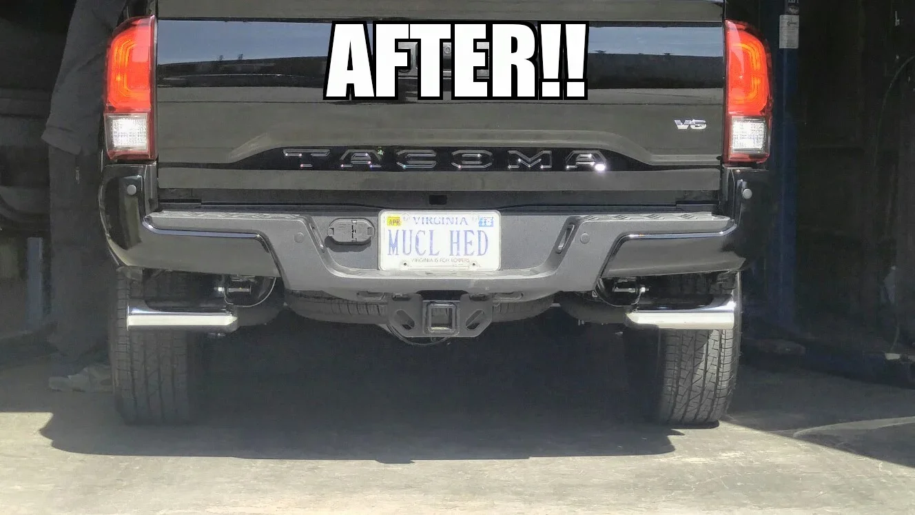

Okay guys, I'm gonna try something. I saw where a guy put 265/75/16 on a stock 2016 like mine, I'm gonna try 275/45/22 with quarter inch spacers from stock without a lift. I have been running 265/40/22 with no issue, just a crappy ride. Here is the picture before, hopefully this works without a leveling kit.....and I really don't want to remove the mudflaps I put on, but here goes. Here is before. Oh yeah, my truck has a Flowmaster Super 44 dual outlet muffler, sounds like a pissed off 350.
