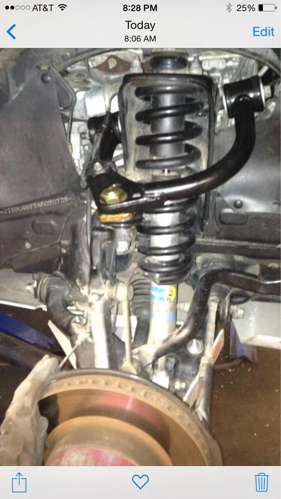

I put 188,000 miles on this setup !
Bilstein 5100's OME 886 because of bumper, winch, and two batteries. Light Racing UCA's. Depending on additional weight 885's for just a new heavier bumper. 884's no additional!
Pro comp and rough country make some pretty cheap budget lifts. The front lift is a strut spacer. The spacer puts a lot of stress on you upper ball joints so when you get a spacer lift start saving for some uniball upper control arms.
5100s all round, ome 885 springs and throw new leafs in the back. Much cheaper and will ride better than stock
