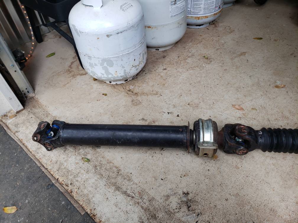

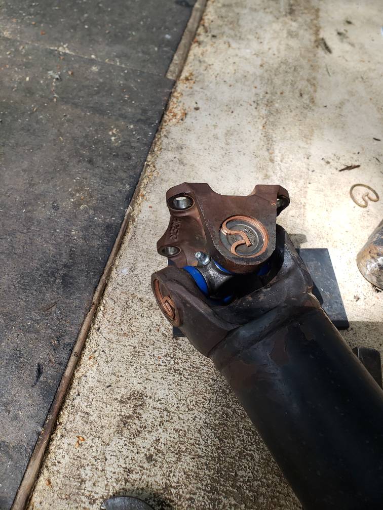

Furthest rear u-joint started chirping after my last long roadtrip, pulling a 6x12 box trailer loaded with tools and gear and also had a strong headwind for 2/3s of the drive... as far as I could tell, the truck did great under the circumstances... but a week or two later Gordo and I were going up a windy mountain road and I heard the chirp echo against a rock face... over the next week it got so loud that it drove me nuts!

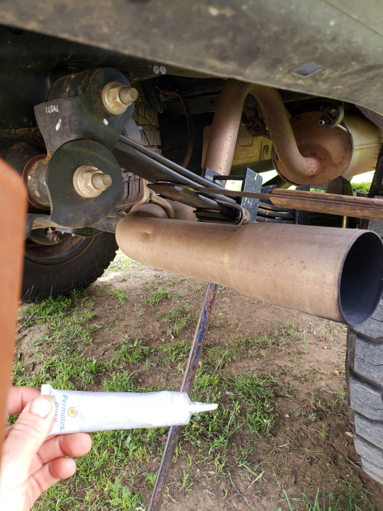

Also, had a terrible leaf spring croak going on.... jacked up the truck by the frame till full rear droop, pried apart the leaves with a flat bar, scraped an impressive amount of crud off of where the pad rides, cleaned and smeared some lithium grease on the pads... so quiet now!!!

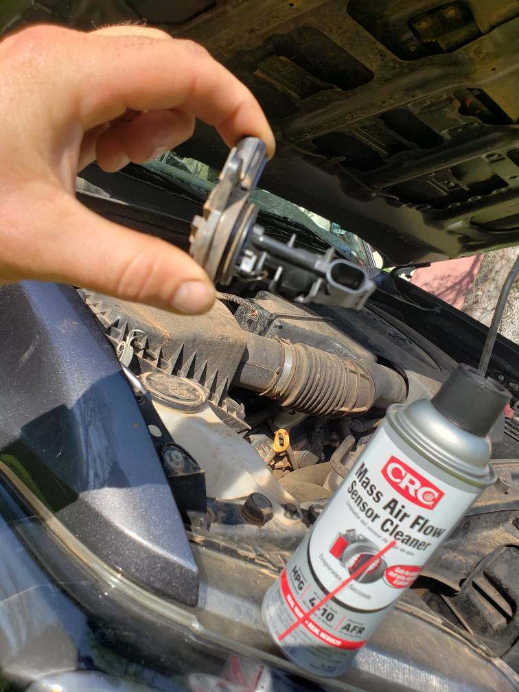

Just do it... Clean your clean your MAF... takes 5 mins, $10 and a philips head screwdriver... I spotted the can at Oreillys and said, "Y not? Just go fart..." the turd has a ruff life... I'm at 56k but...
[emoji444]To be faaair...[emoji445]
A lot of those miles were on dirt...
I wasn't sure if cleaning it would make a noticeable difference but the one thing I noticed is that take offs are much smoother and "cleaner" is the only way I know how to say it... as an MT, I occasionally get the annoying bucking and snorting when I try to take off gently and I say, "Fecks sake, knock it off! You're embarrassing me!"
Anyhoo... it definitely didn't hurt...
Don't touch it, don't drop it, don't bang it around the hole... gently unplug it, give it a little twist as you pull out, it's just an o-ring... it has an arrow for air flow...
A video I watched said 15 short burst of the cleaner on the little wire and the hole and just spray it all off... air dry, preferably in the sun... only took a few mins. Don't blow on it... 20200418_162852.jpg

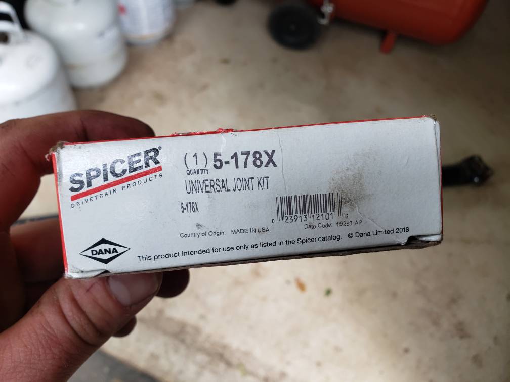

Did the other 2 rear u joints today... heard a faint chirp bringing a load to the dump a couple days ago...
I thought, "Sunnuvaaaa... I changed the wrong one..." but I never heard it again after I unhooked from the trailer later that day... I think they were all in about the same shape... now I has zerks everywhere... I'm happy... the front driveshaft came with zerks... they took about 5 shots of grease each...
Part number below for those of you who like to lube your shyt like me... [emoji23]
* PS- It's not hard to line up all your zerks for future convenience... [emoji106]

Just do it... takes 5 mins, $10 and a philips screwdriver... I spotted it at Oreillys and said, "Y not? Just go fart..." the turd has a ruff life... I'm at 56k but...
I wasn't sure if it'd make a noticeable difference but the one thing I noticed is that take offs are much smoother and "cleaner" is the only way I know how to say it... as an MT, I occasionally get the annoying bucking and snorting when I try to take off gently and I say, "Fecks sake, knock it off! You're embarrassing me!"
A video I watched said 15 short burst of the cleaner on the little wire and the hole and just spray it all off... air dry, preferably in the sun... only took a few mins. Don't blow on it... View attachment 29744
