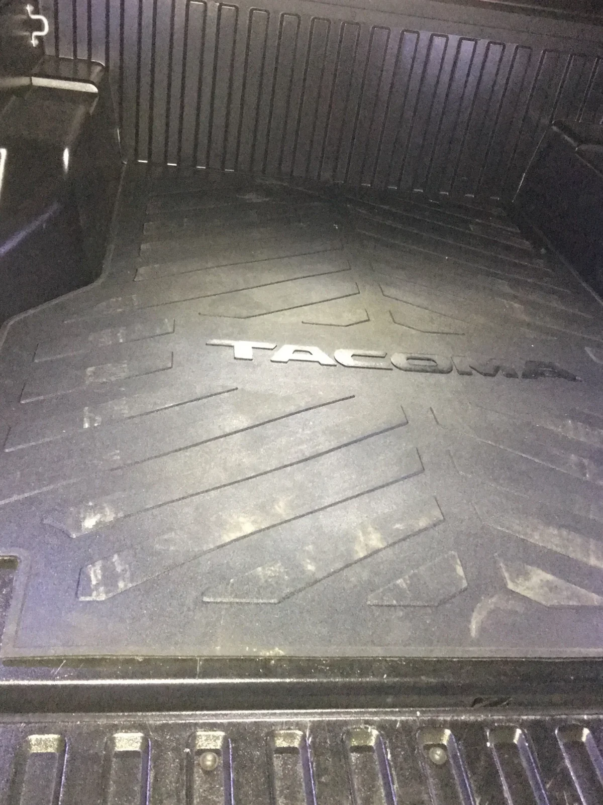

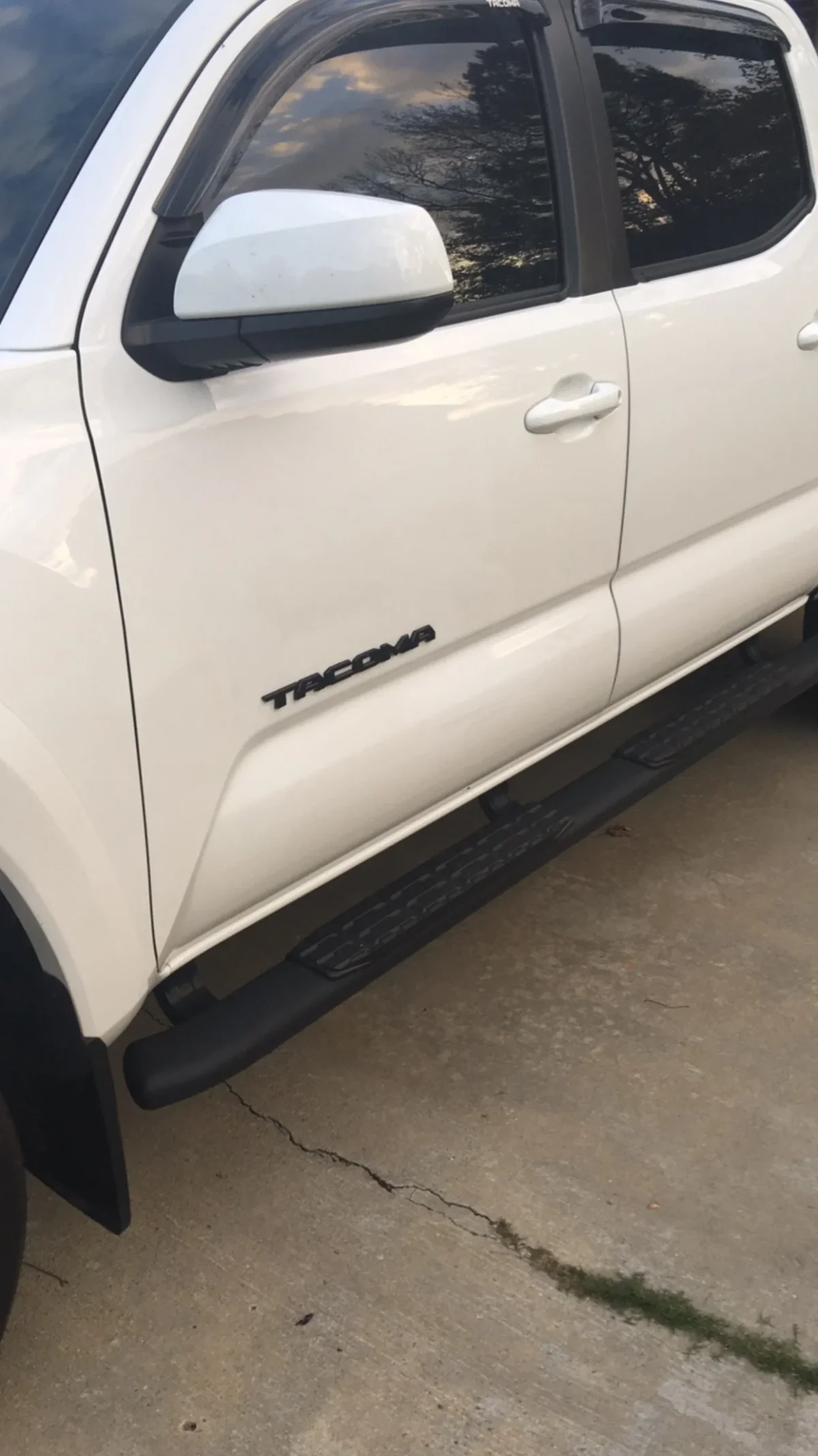

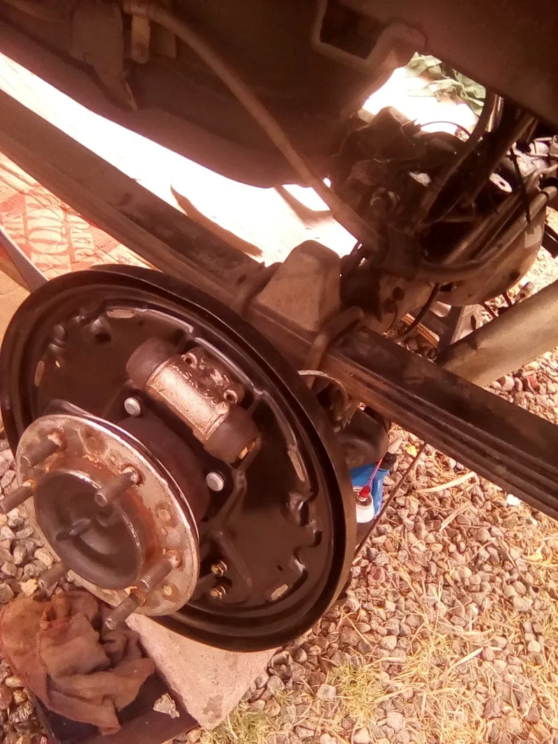

    Well, I've got new 3rd member in & it's sealed & snug, diff lube is in & buttoned up tight I'd be rolling now except when pressing the ABS ring/retainers the guy pressed them on too far so off it comes (broken of course) He ordered new ones & are going to over night them so should be here by morning from L.A., damn, always some little bullshit thing when I'm so close to being done...

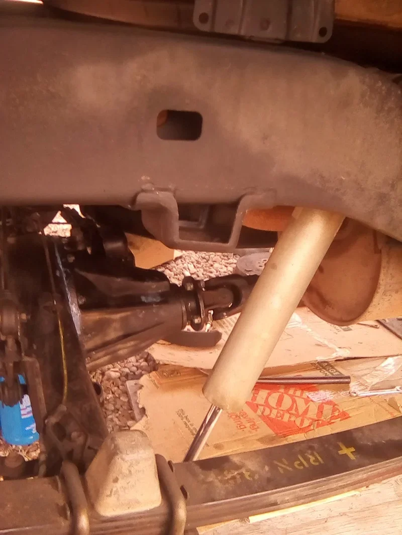

    Ok, axles are in & buttoned up, drive shaft correct & tight , just gotta finish the rear brakes, bleed, put tires back on & theeeeeennnnnn lift off !! haha, Should be rolling in about an hour or so....

  17. OR17TRD
    Do you know what caused it to Grenade?
  18. Bogunn
    I was wondering the same thing.
  19. 4wd
    4wd Well-Known Member
    It's not too bad except for those damned drum brakes , I still don't like doing them, wait till I do my lower ball joints /CV's/ Eibach coils, for me that's a lot of work (more in depth than rear obviously) It'll be fun tho'..take my time , crack a cold one ,hell might even twist one up
    !! (doubtful, then I just want fritters man,ohhhh the fritters)
    Yeah weather's been nice for this, now I'm done send us some rain, we really need it...:)
    Couple factors, we found that the original seal/bearing was pressed too far from factory causing a very slow,yet very certain death (internal leakage) & it literally bled out & I'm confirming a suspicion I've had for awhile,,, 1st gen TRD diff's aren't as strong as I had believed (Elockers)... Makes me sad.... My '83 could handle a V8 conversion, not so much with newer 1st gens & 2nd gen owners rest easy (3rd genners might need to worry TSB on diffs ), pretty sure they share the Tundra axle....
