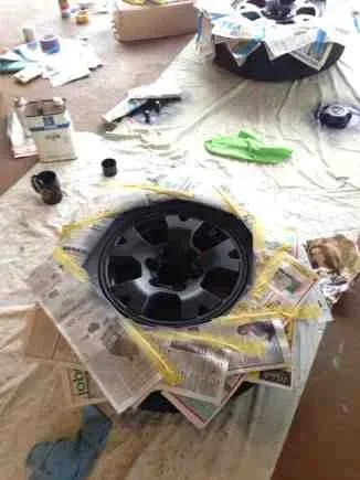

Also when you dip your wheels, make sure you clean them extremely well, and make sure they are completely dry. And make sure you cover the whole wheel in dip with at least 4 coats. My friend didn't cover his very well so it started to peel.

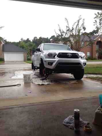

The first hour I thought I was gonna die. The Florida sun takes no prisoners. Now that I know what I'm doing, if I had 4 jack stands I could do this in a day

I had to learn the hard way. Today
I had to peel the 2 wheels I did

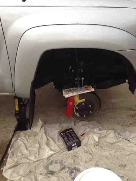

Yesterday. My brake calipers came out

Tacoma brake calipers are the easiest
Thing in the world to paint . A few
Strips of tape is all that's needed
