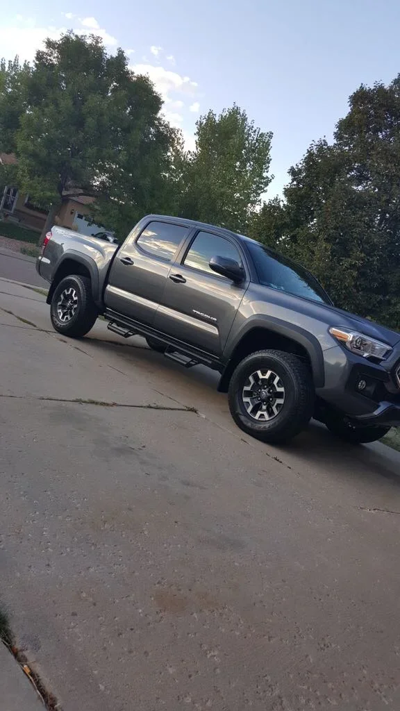

Looking on getting wheels for my 2016 Trd Off-road . Which you buy any why? [I am looking at a Toytec 3.5 Lift and then the wheels. Just need a little help. Here is What I am working with
ATTACH=full]7194[/ATTACH]

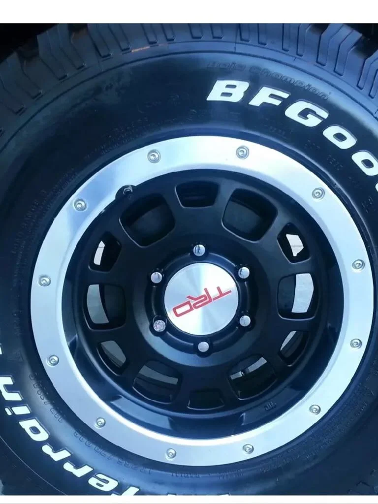

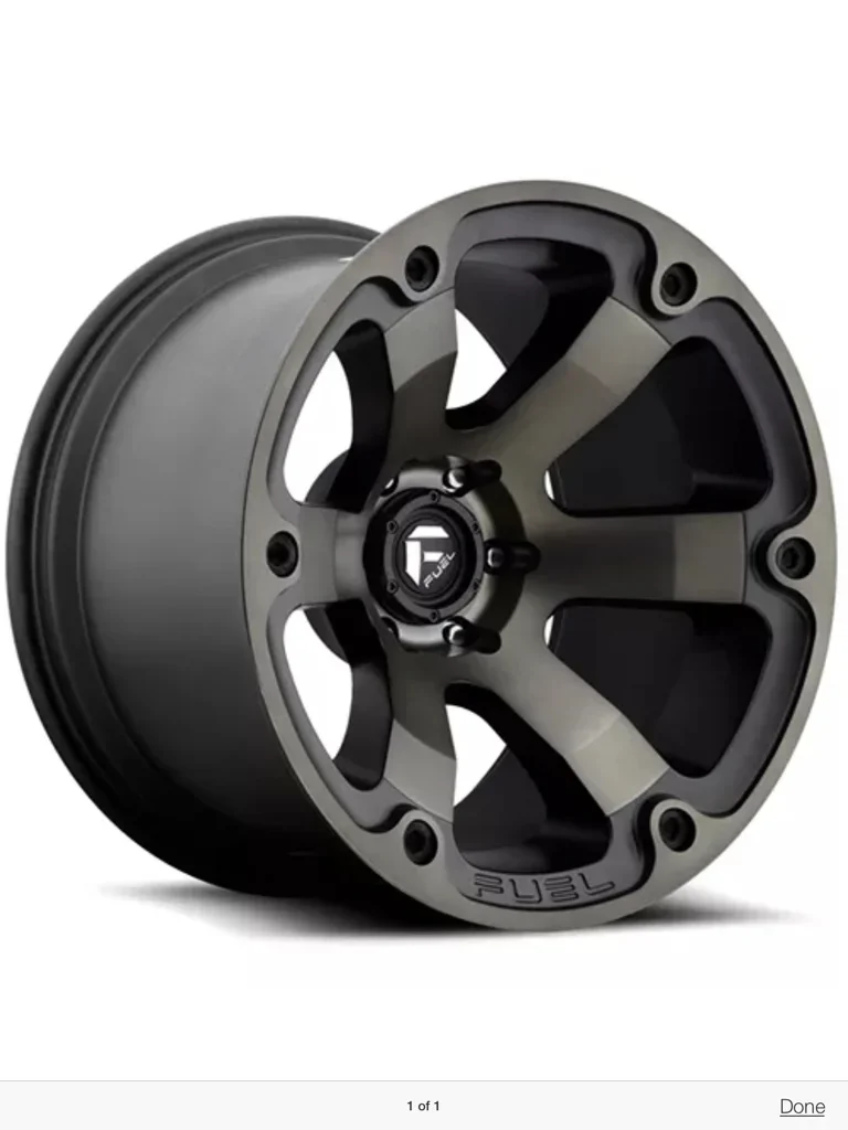

Here's what I have cut my decision to. Which would you buy as they pretty much cost around the same price.
OR
OR

If go with the Fuel wheels. I think they match your truck better.
Thx Demo Man that was my choice as well..

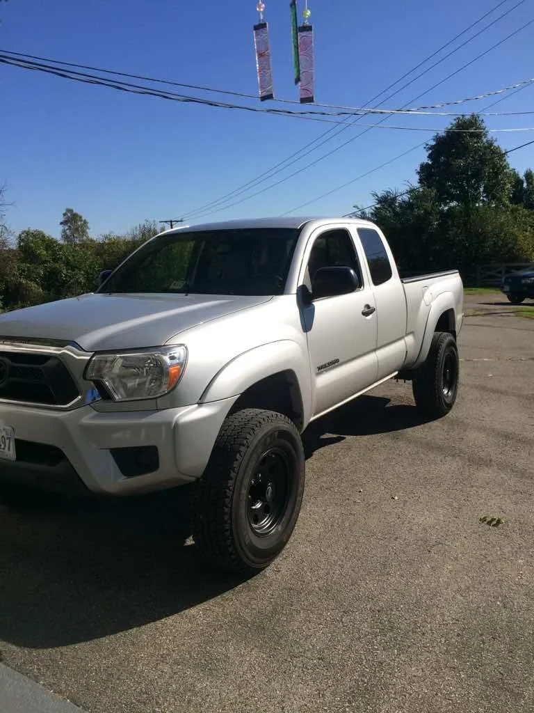

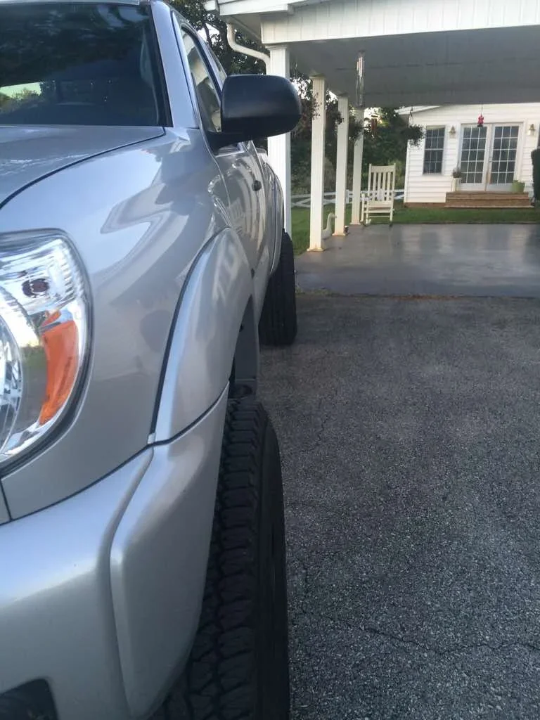

I got 16x8 with 4.5" backspacing. When I had them installed the rubbed the brake calipers so I also had to run 1.25" wheel spacersImageUploadedByTaco Forum1446247596.881415.jpgImageUploadedByTaco Forum1446247618.746055.jpg
That's about right I was advised to buy wheels with a zero off set it would take away the spacers . Th ET number stamped in back of the wheels should be 0-18 for them to fit without a spacer is what I was advised..

Mine are 0mm offset
Zero and still rubbed on calipers? I better do a little more research before I lay my cash out. I want wheels with no rubbing. What size were rims 16. 17?

They are 16" wheels. I thought I did all my research until I went to have them installed. Lol
