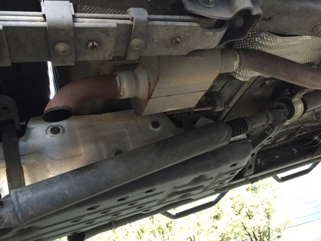

ImageUploadedByTaco Forum1428860751.976036.jpgI have a loud exhaust, but I also have good ears and can hear the smog pump errday... Let us know if it turns out to be something else
