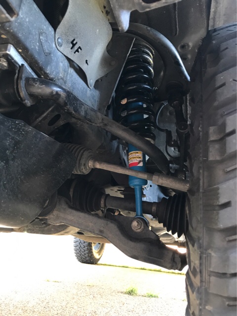

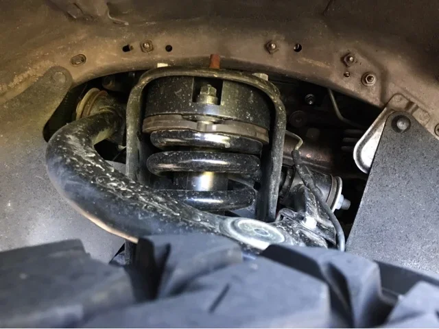

I took my stock ones off and put them up against the 2016 TRD coilovers and they are the same length.

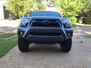

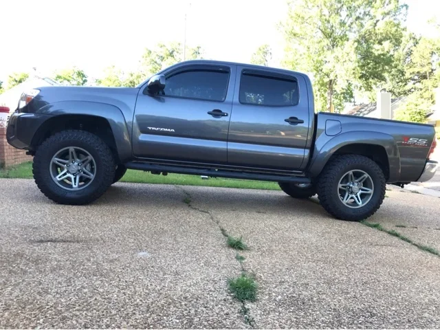

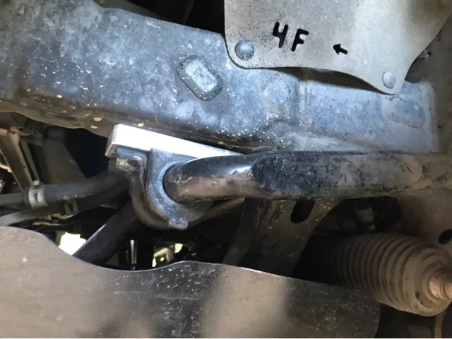

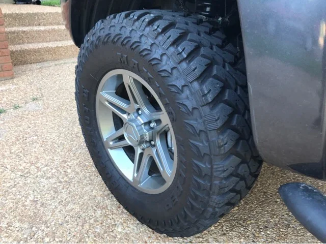

It did give me an inch but a lot smoother ride. I also have a 3" spacer with the sway bar drop bracket. Gonna need to get an alignment finish it off. Also running 285/75/17 mud tires. I'll post pics later today
Nice, looks like it worked up front. Are you going to bring the rear up? It's got a bro lean.
Lol yeah... I don't want blocks. I'm gonna put new springs on it cause the ones on it are bad
