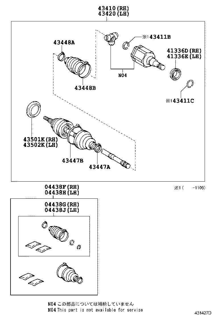

'11 taco Leaky front CV axle on driver side...
JayQQ97
MW surVivor ... clutched. 360k on the 0D0
noted on the multi-point inspection yesterday
its flinging grease they said :eek:
is it best to put a reMan axle in or to get the boot kit and attempt to reBoot it
i think its just the inboard side
Remanufactured Shaft Assembly Front - Toyota (43430-04070-84)​
A boot is not a seal. The purpose of the boot is to prevent debris and schmutz from entering sensitive areas.
You probably don't need an axle or driveshaft.
You likely only need a seal. When the assembly is apart then the other parts can be evaluated for damage.
the dealer said they do not reboot stuff
they just slap a new or possible reman cv axle in there... probably would cost over 700$
the car nut guy would say to reboot it
i just might do that!
