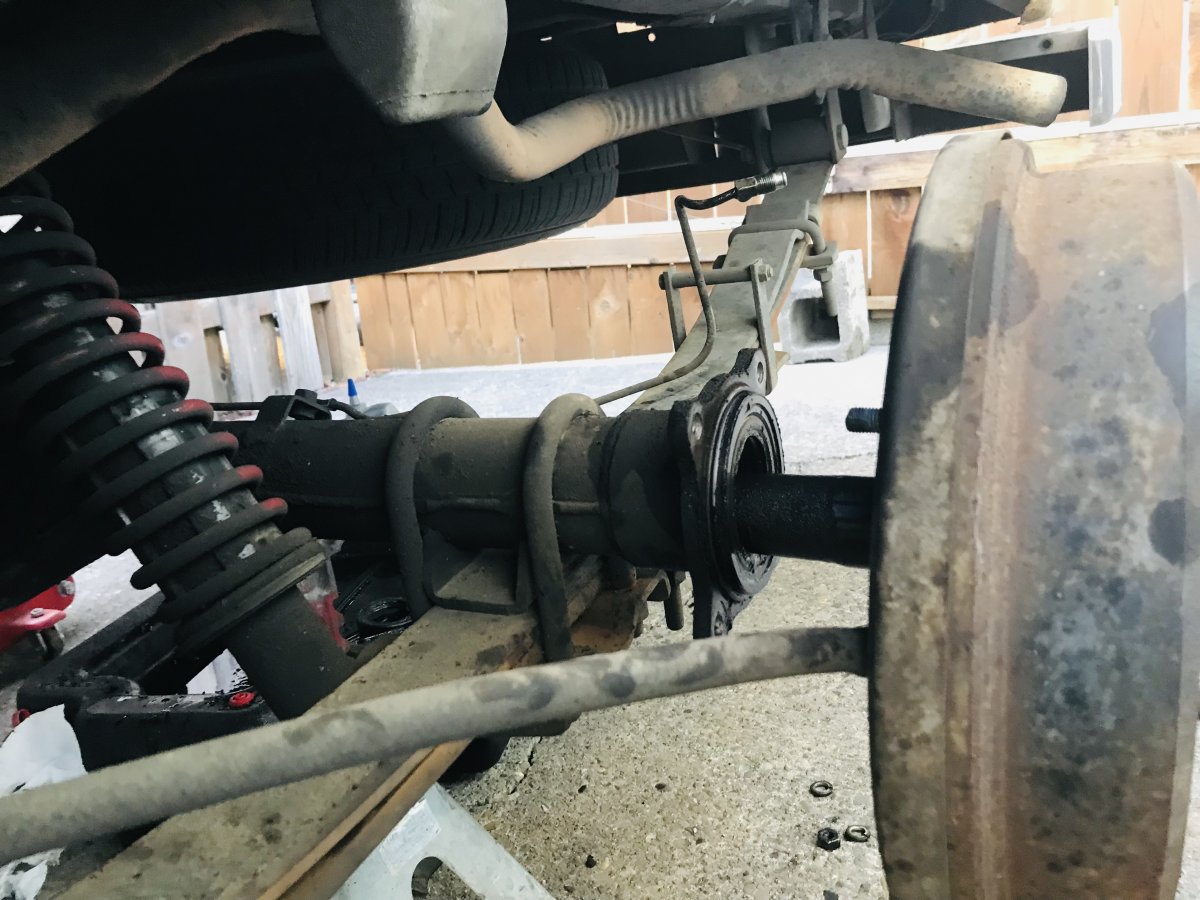

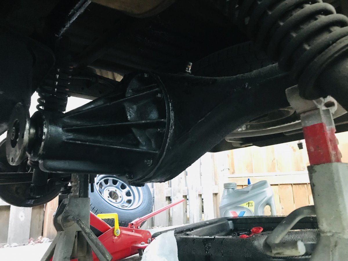

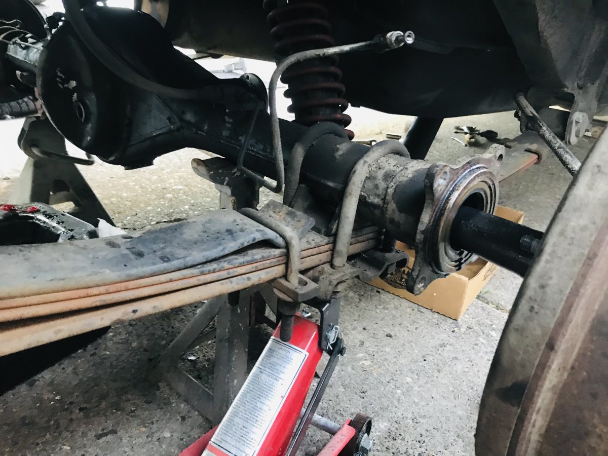

Got the rear diff re sealed today. What a PITA haha. Have to unhook the brake lines and pull the axels out. Didn’t help the auto parts store gave me the wrong gasket. I had some RTV so I used it instead. Probably be better in the long run.

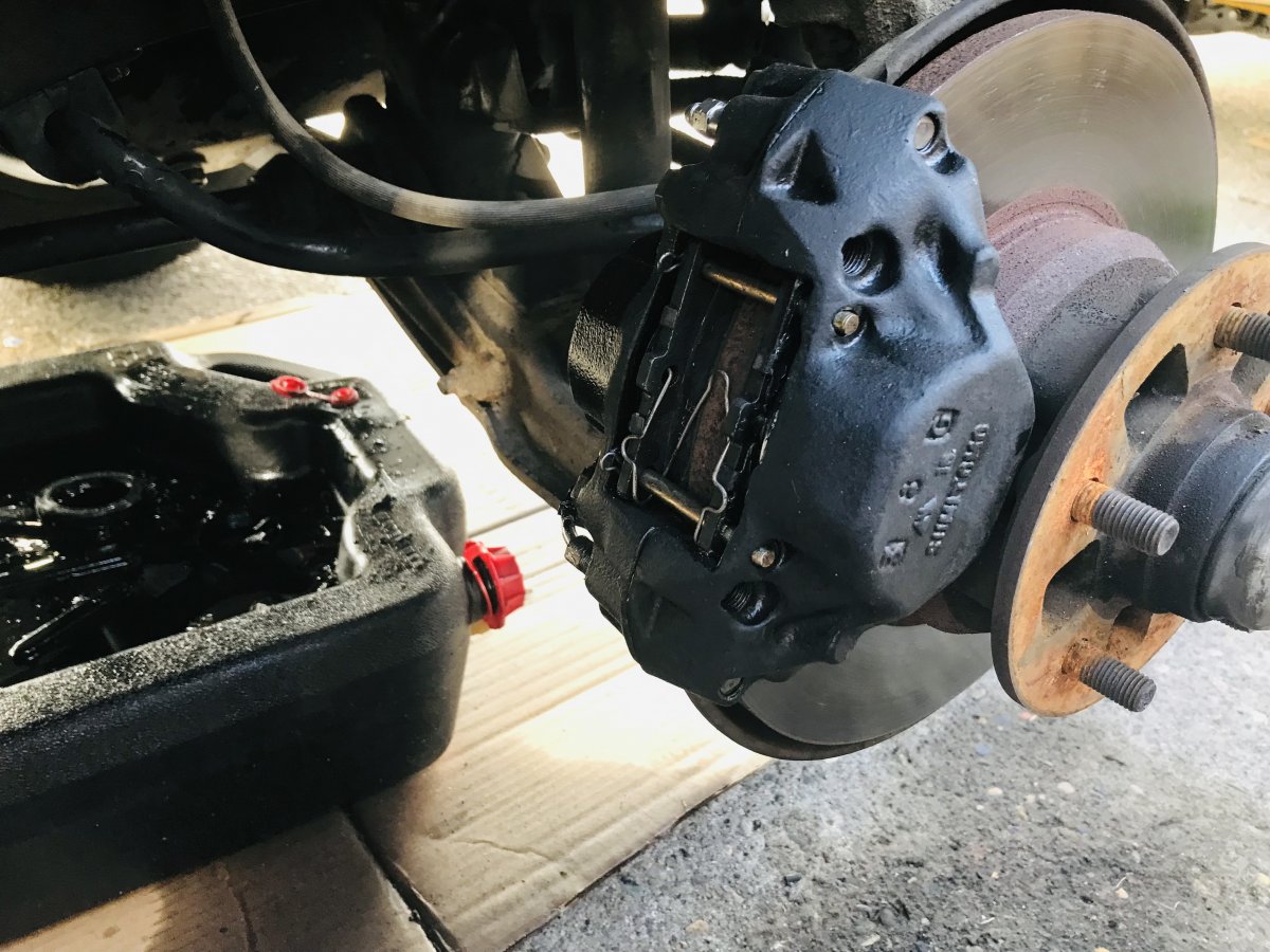

Did the front brakes and transmission today.
Calipers were shot. I found some refabbed ones for $40 each
Drained and replaced the brake fluid as well.

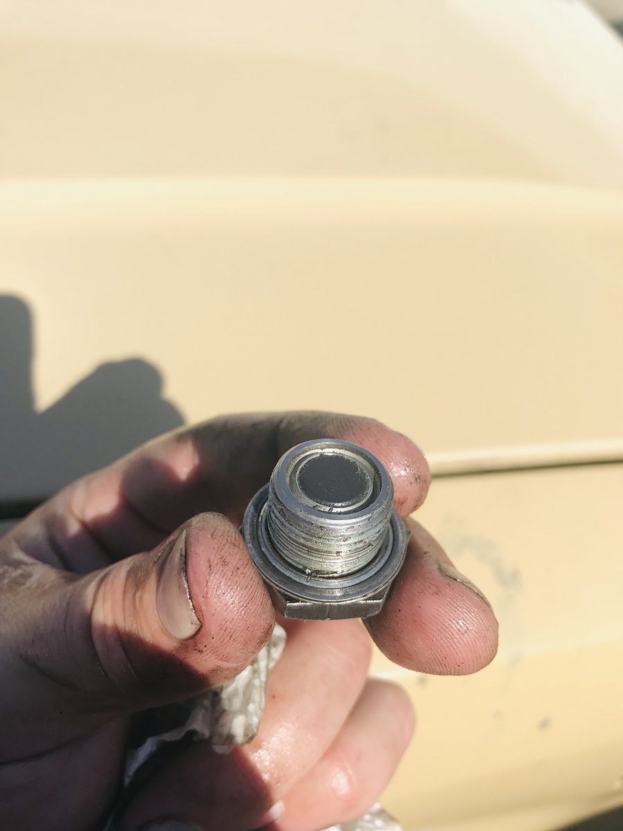

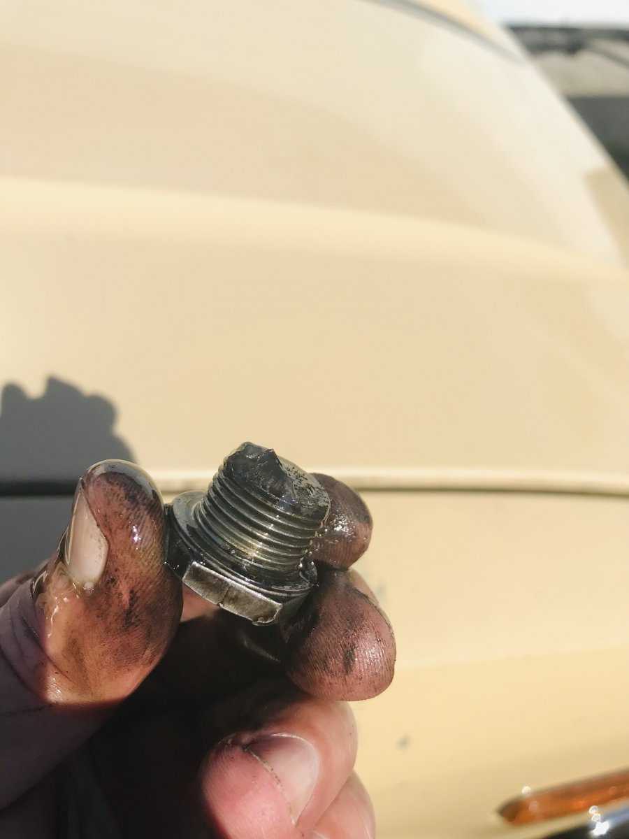

drained and filled the transmission. The fill plug had some good stuff on it.

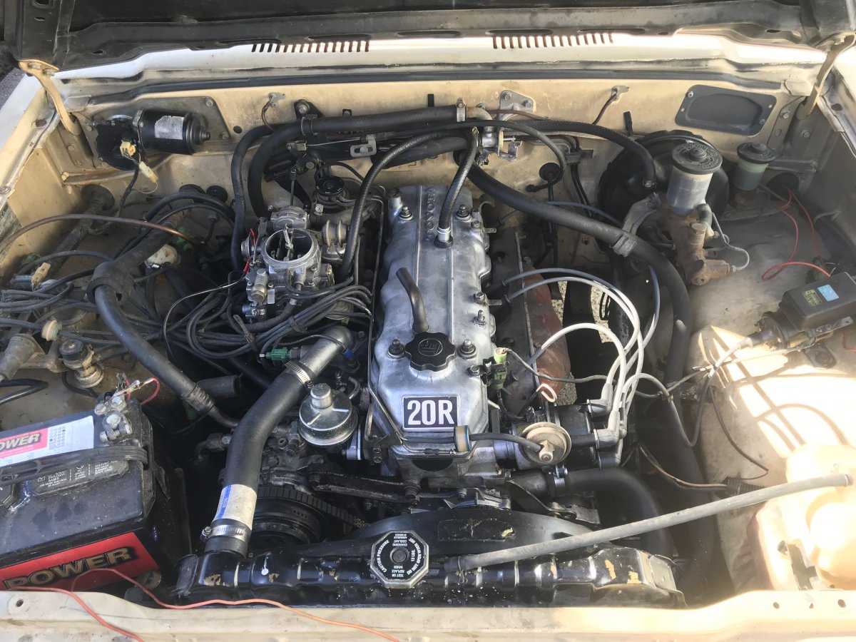

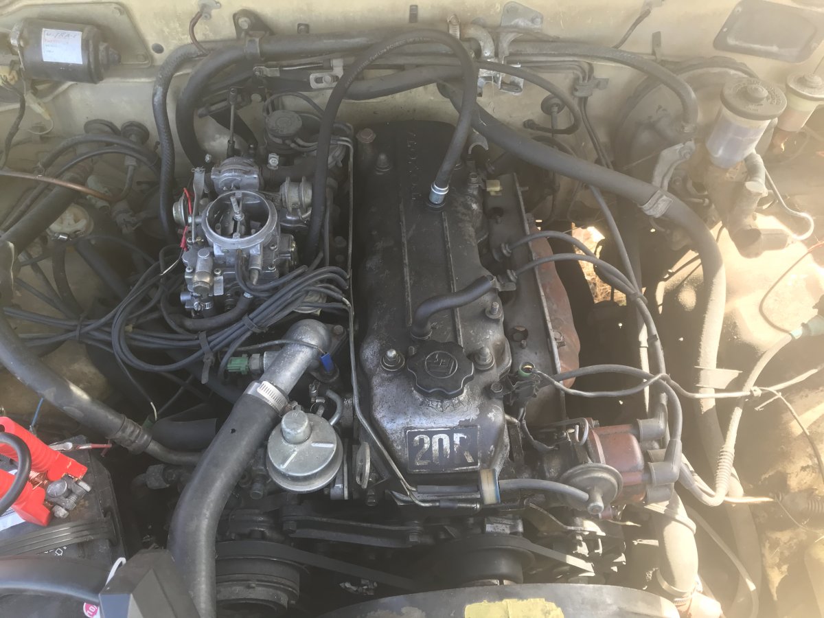

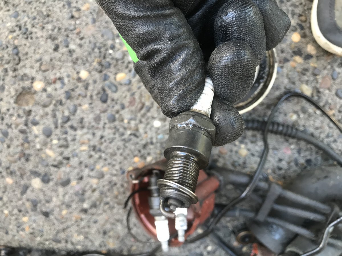

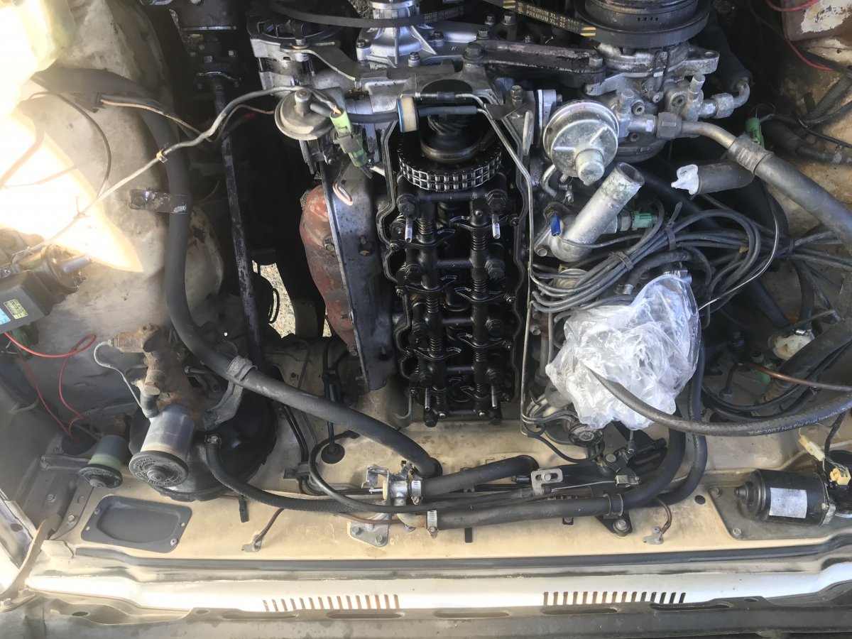

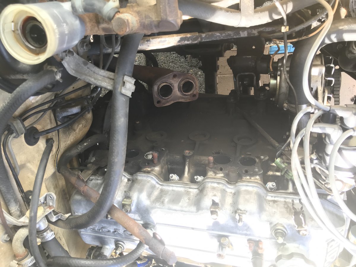

I need to clean it up with some simple green so it’s not so greasy to work on. Looks like the front main seal is leaking. I need to get a gasket kit for it and start taking it apart. It has some pretty good exhaust leaks through the pipe. It’s leaking from the thermostat housing and one of the radiator tubes. Spark plugs look old and the distributor and wires probably need to be replaced.

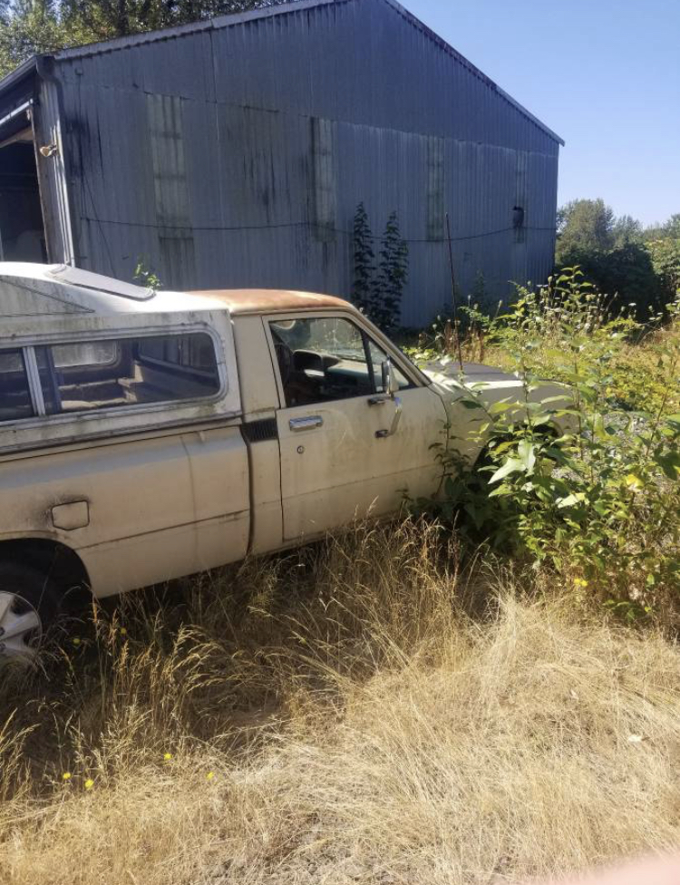

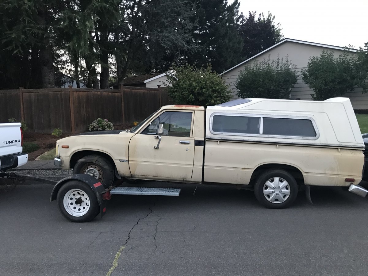

There is a guy up in Washington state that has a bunch of parts from these older Toyota's. I know lots of these older Toyota’s are getting cut up and taken somewhere south. I’m assuming Mexico. I’ve seen carivans of them headed on I-5 south bound. 0F1C0CC5-1CCB-428C-A722-ABE52E9C6701.jpeg447B3338-2D7B-4EC7-BD85-18277344115C.jpegF451768C-D47F-4B62-BFE3-1AE8EC36C0F6.jpeg
I bought two and have a donner. I might buy another one just to have parts. I’ve found some interior parts on eBay. Most is the drive train stuff you can find aftermarket. https://www.partsgeek.com/ymm/1980/toyota/pickup.html
There is a guy up in Washington state that has a bunch of parts from these older Toyota's. I know lots of these older Toyota’s are getting cut up and taken somewhere south. I’m assuming Mexico. I’ve seen carivans of them headed on I-5 south bound. View attachment 33045View attachment 33046View attachment 33047
