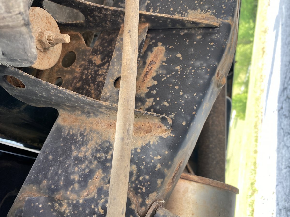

So I took my 2012 Tacoma into the dealer for the Toyota CRC application due to the rusty frame warranty extension / recall. I thought they would wire brush the frame and then apply the compound to the whole thing. Nope. The first pic shows the side of the frame pointed outside and has zero compound on it and you can see all the rust spots. The 2nd photo shows the inner side of the frame which looks like they just put a bead of compound in the seams. Is this how it is supposed to be done?
*** Frame angle from the outside of the Truck** 1 day after CRC application

Yup. They clean and dry the inside near the front then fill it with goo then plug holes to try and keep water out. Then lay in beads along seams the rest of the frame.
That sounds, looks like a spit ball approach to a fix. What ever happened to actual rust proofing? Ziebart has been around for decades plus now there are a multitude of companies offering some sort of rust proofing and treatments. It's a shame to buy a vehicle that mechanically will last virtually forever only to have it rust away because the manufacturer is too cheap to treat the underside.
I would think grinding out the rust before applying any kind of rust preventative would be standard procedure. Then use the inhibitor to stop any further rusting on the entire frame.

Toyota will only do parts of the insides of the boxed in frame with their crc goop. It's still your responsibility to keep the rest of the chassis from rusting out.
Op needs to wire wheel the rust away...then use a rust converter like rustoleum sells over the bare steel. When that cures, only then the frame can be painted with a black chassis paint. Op can now choose their favorite flavor of a rust inhibitor to spray on like fluid flim, or cosmoline. It should be inspected year to year for needing any touchups, or re-applications if using a lanolin based rust inhibitor.
