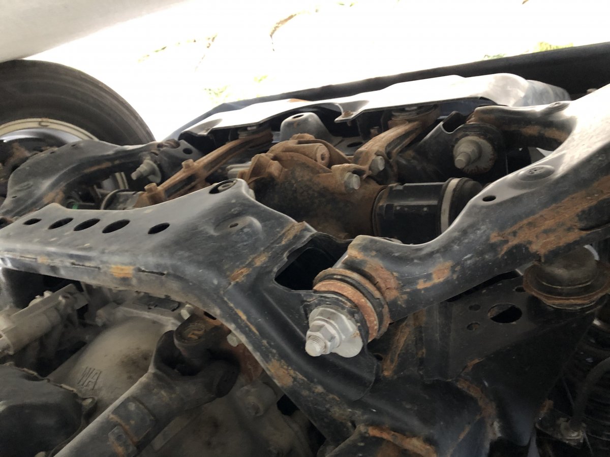

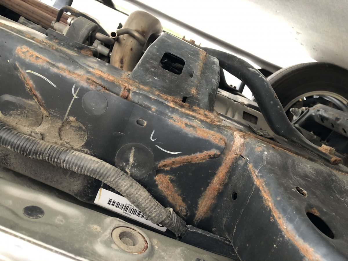

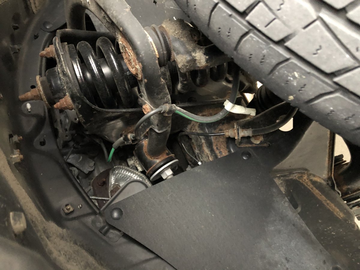

Hey guys, I’m new to the forum and might be beating a dead horse on this one so bare with me... I just got a 2017 Tacoma SR5 and noticed that basically all the frame welds are collecting rust, the bolts look like they have been on the truck since 2002. Anyone else have this issue?

Holy cow man! Where do you live???
I'm guessing there's lots of salt on the roads during winter? I'd take a trip to the dealership and talk about a frame replacement... Unfortunately, this has been an issue since 05, they've used this same frame for 15 years.

I live in SLC Utah, so yes the roads are coated in salt during the winter.

Doesn't look bad enough for a frame replacement IMO. I would be doing some sanding and repainting and then keep it covered with fluid film
That was my first thought... wire brush and a gallon of chassis paint but then I said, "wait a minute, this is a 3 year old truck... taking on a frame project should involve a truck with antique plates..." [emoji23]
