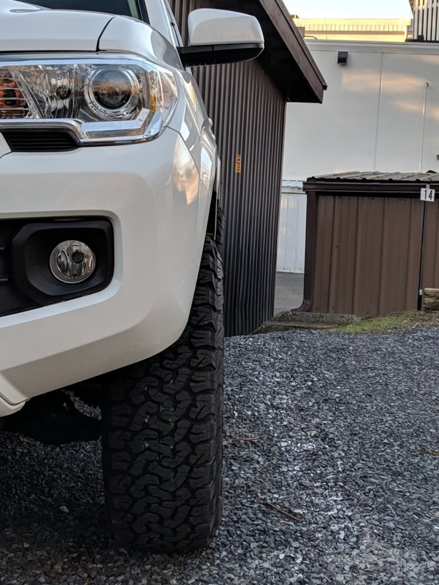

This is not my truck, this truck got 8inch wheels with o offset and 265s..I like what I see. With 8.5 wheels and 0 offset another half inch out?...
IMG_20190228_170837.jpg this
1/4” maybe. 0.5” is total width.
