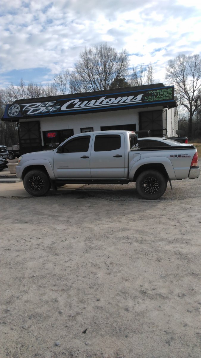

This is it now
I'm going up 3 inches in the front and 2 inches in the backPrerunners can run a spindle lift in the front for 4 inches. You would need new leaf packs for the rear. I would go this route over Junk Country or coilover lift on a prerunner if you just want the look.
ThanksGood looking taco

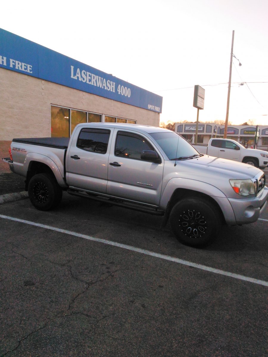

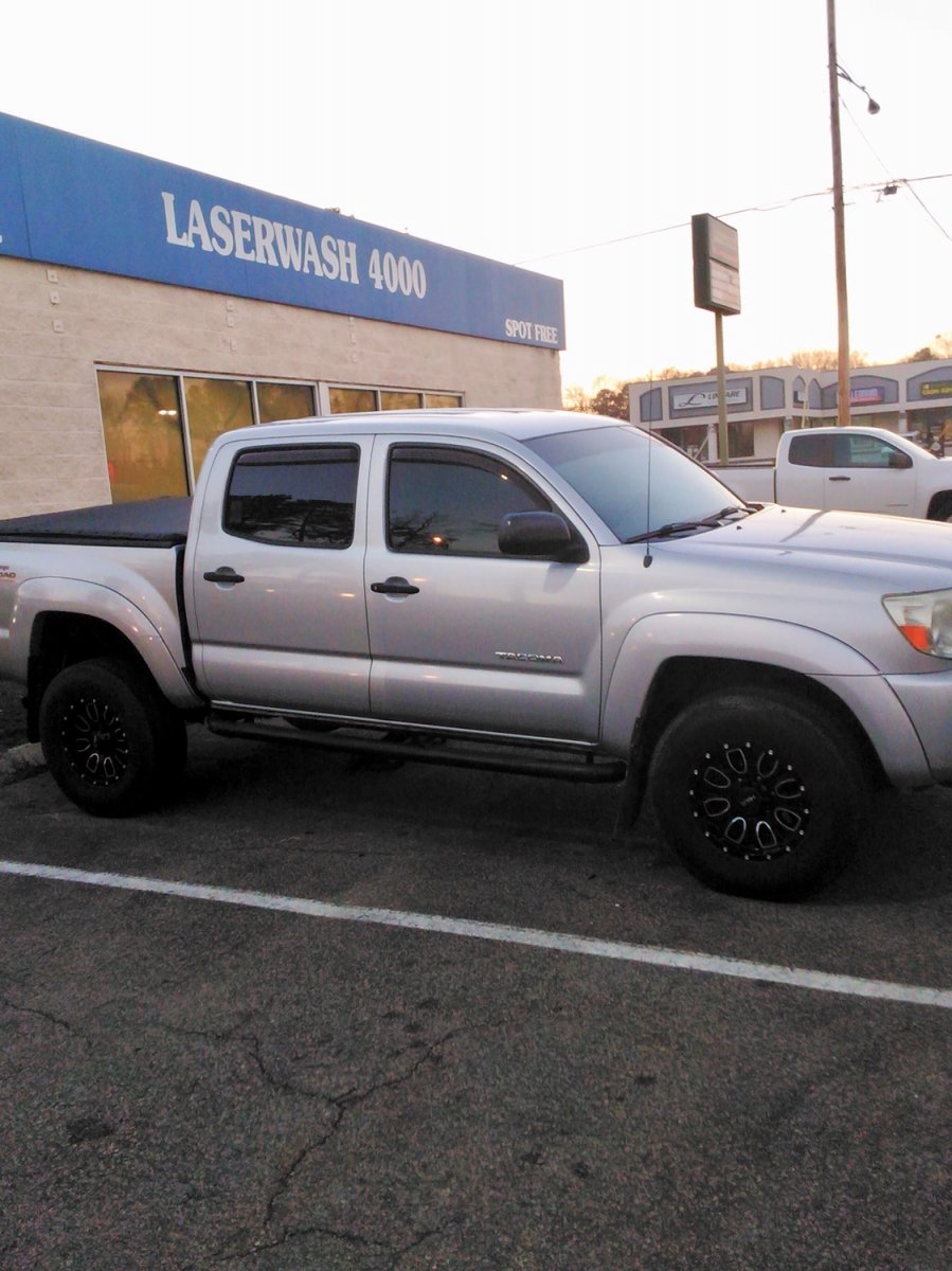

Is it just me or is this thing ass high?This is it now
If you’re going to get and spend money on new shocks and struts don’t get a spacer lift or a ruff country lift. Like @whippersnapper02 saod get some spindles do it right and love your taco. Spend once, cry once, love forever.Even with new shocks and struts?
+1Prerunners can run a spindle lift in the front for 4 inches. You would need new leaf packs for the rear. I would go this route over Junk Country or coilover lift on a prerunner if you just want the look.
