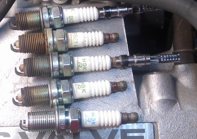

Just curious if it even matters which NGK spark plug to use out of the replacement list?
I think the original plugs for the 3RZ-FE are Nippon Denso ND K16R-U, gapped at 0.031" (sometimes listed as 0.032") at 14ftlbs (dry, at no anti-seize) torque.
The NGK web site lists suitable replacements as
1. Standard NGK BKR5ES
2. OE NGK BKR5EYA
3. GPower NGK BKR5EGP
4. Iridium NGK BKR5EIX
5 Ruthenium NGK FR5BHX
Pricewise, they are roughly equivalent given there are only 4 of them and they're pretty inexpensive so the question isn't at all about price.
Which works "right"?
Presumably, all the marketing aside, I can't go wrong with OE.
But does anyone have good or bad experiences with the other variants?
(And, yes, I will avoid Bosch at all costs.)
